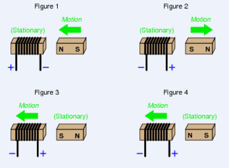

Why is the Voltage induced on the secondary of a transformer in phase with the primary? As far as I know, lens law states that any induced voltage on a coil is 180 degrees out of phase with the coil that generated magnetic field. Otherwise you could have infinite energy systems, lol.
Is the reason the voltage is always seen to be in phase on the secondary with the primary because of the windings, when it reality the Voltage is actually 180 degrees out of phase? I always figured since the Back-emf is opposite the primary voltage, the secondary is as well since it is created from that same magnetic field.
Please help, I have read plenty on transformers and this is just one thing I do not get?
Here is one good source I found but I just don't get why.
http://www.allaboutcircuits.com/vol_2/chpt_9/1.html

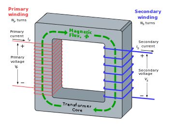

i knew the back voltage on the primary would be 180 degrees out of phase, but I think now i understand better why you refer to the voltage induced in the secondary as back-voltage, since it is in time (phase) with the backvoltage in the primary.
however, I thought the right-hand rule would indicate the secondary current flowing in the other direction in this picture, so I'm still off on this somewhere. what am i missing?

Yes, I think the secondary voltage shown in that diagram is wrong too.
If you follow the winding direction around the top of the core, the secondary is a continuation of the primary winding, (with turns missing, of course), so the bottom of the secondary winding should have the same polarity as the top of the primary.

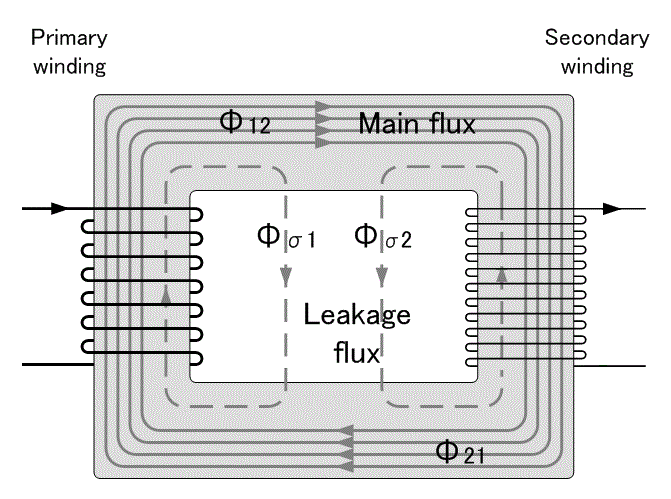

I notice in the Wikipedia article, in the "Talk" section at the top of the article, there is discussion that a similar diagram is wrong. As far as I can see, the diagrams are identical in function so this one is probably wrong too.
This is the one the author admits is wrong:
But he still claims this one is right:
I can't see any difference.
I think the diagrams are correct. The polarity of the applied primary voltage is to cause current to flow in the primary (The primary back emf will have the same poarity).
The polarity of the secondary emf is the polarity of the voltage generated IN THE COIL...this is an emf source and current flows from - to + through the emf source.
Hope this helps
I also think that the diagram are correct. Simply use right-hand rule and you will see that every think is OK. Also kept in mind that the voltage on the secondary winding is the induced voltage (emf). And the polarity of this induced voltage is determined by Lenz's Law. The secondary winding will generate the emf voltage in such a direction to create magnetics field that is oppose the primary winding magnetic field .

The only difference between the top diagram and the bottom diagram is that no polarity is shown on the terminals in the top diagram. If they are both marked + then that will be correct and both diagrams will match.
Thanks for the replies, hope nobody minds I kinda hijacked Nemesiswes' thread :biggrin:
The diagrams in Jony130's post I think I understand- the polarity of the magnet being reversed changes the polarity of the induced voltage.
Where you may have to help me again is to understand the polarity of the transformer core as a ring. I thought it wasn't that it had any magnetism of its own (except for the small amount in the magnetic hysteresis loop) but was just a conductor for the flux coming out of the primary. I think that when currents make a magnetic field the right-hand rule applies to the direction to the flux. is the reverse true for a flux inducing a current?
this is great - thanks for the answers.
Also, I see no difference in the wikipedia diagrams, except that the leakage flux in the secondary is opposed to the flux coming directly through the core into the secondary. probably just showing my ignorance here, again...
Remember that if any current is flowing in the secondary coil it is opposing the change in flux caused by the primary current.
If no current is being drawn from the secondary there will be no flux due to the secondary.
