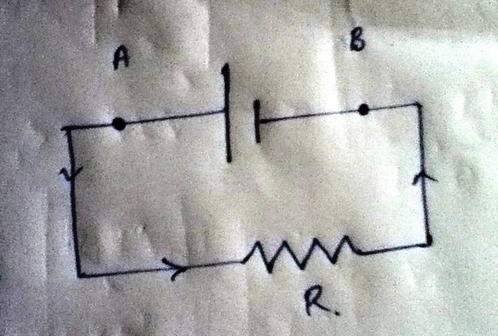

Okay so are EMF and Potential Difference the same thing ? I know they are now but I am not able to understand how ?
I came through this Derivation today if someone could explain it to me it would be great
The figure shows a battery connected to a resistor
V(A) - V(B) = V(b) = ε (emf)
what the Derivation says is if we Remove the resistor R the resistance becomes infinitely large (HOW?) . So R = ∞ therefore the current
I = V/R = 0 So the current flowing would be zero
Now , the derivation says that there is always an internal resistance (r(i)) present inside the battery . So now if we again Connect the Resistor R
so ε = I(R+r(i)) (HOW? IS OHM's law used here ?)
Further it says , now V(b) = IR = ε - I(i) (Why is V(b) not I(R+r(i)) ? )
So the ε is greater than the V(b) . Please someone explain this Derivation .
The first fault here is that when the resistor is removed the resistance becomes 0 and not infinite. Please read it again. As the resistance becomes 0 an infinite amount of current flows by- I=V/R ; R=0 => I= infinite.

For potential difference to be constant, there must be some force inside the battery that must be bringing back the negative charge to the -ve electrode and hence doesn't let it to nullify the +ve charge on +ve electrode. The work done per unit charge by this inside force is EMF.
This all EMF work occurs in the liquid of cell, but the wires that act as elecrodes also have resistance thus till the current comes to the terminals of battery it has to do work against that resistance therefore its output potential (V(b) in your diagram ) will be lesser than EMF.
Potential difference of a cell is the potential difference across the terminals of the cell.
Further, V(b) is not = I(R + r(i)) because it is the potential difference at the liquids of cell and not at the terminals of the cell.

Not exactly. The EMF is the chemical potential difference of the battery. The voltage across A to B will equal the EMF minus any IR drop due to the internal resistance of the battery.
They mean if you disconnect the resistor, leaving a gap in the circuit. No current will flow.
Yep, just Ohm's law. The emf drives the current through the total resistance.
V(b) is the voltage across R, so V(b) = IR (Ohm's law). It's also the voltage across the battery, so V(b) = ε - Ir(i). (Ohm's law again.)
Sure. The effective voltage across the battery is reduced by the internal resistance.

Thanks all its much clearer now . Thanks for the Detailed Explanation @Doc Al
The essential thing to note is that EMF is where Energy is supplied to the flow of charge and can relate to chemical cells, dynamoes, solar cells etc.
Potential difference relates to where energy is dissipated.
The sum of the potential differences equals the sum of the EMFs is an example of conservationof energy.
It is energy that brings out the subtle difference between EMF and PD
