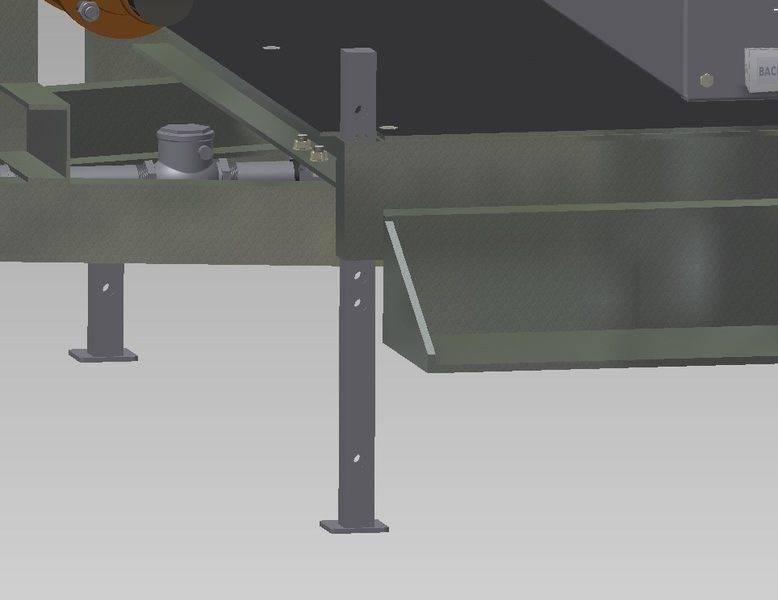

Hi, I hope someone can help, I'm trying to design a trailer which uses adjustable legs on each corner as support legs while it is is use.
The legs are adjustable and have drilled holes for the position pins, and I am trying to work out what wall thickness of leg will be adequate to provide enough strength. The outside dimension of the leg is fixed, as is the pin diameter, only the wall thickness and hole spacings can be varied (see attached image).
I'm looking for a calculation on the stress, or assistance on how to work this out please? I'm sure there is an easy answer but I'm struggling...
The legs are 38mm (1 1/2") square/box section (hollow) 316SS if that is of any help... and the holes are 16mm diameter..

Thanks Danger,
Currently we've spec'ed 38mm hollow box, 1.6mm wall section SS316. The trailer weighs 2200kg total with a support leg on each of the 4 corners.
The holes on the support leg are currently at 34mm centres, with 5 holes if that makes a difference?

The real issue is that the trailer (we're modifying an existing trailer) already has 38 x 1.6mm box section SS legs, and we need to drill new holes half-way between the existing ones as they are now at the wrong height. I'm just wondering how to calculate whether or not this is going to have a big effect or not?
And if it is, we obviously have the option of building new legs to go in the existing slots.
SS316 is necessary because of the corrosion issues in it's application, so no other material can be considered.
There must be a calculation to work out stresses on a vertical box section (probably without without holes?) I would have thought?
I suspect that you'd be better off building new ones, but that is also an amateur opinion. One other thought that comes to me, though, is that any new holes that you drill should perhaps be at 90° to the originals. I'm not sure, but it seems to me that it would equalize the stresses better that way.

simelliott: Using your 38 x 1.6 mm stainless steel SAE 316 square tube, the uniform axial stress, pin hole bearing stress, and buckling strength currently look OK.
But is there anything else in your system, other than these four legs, to resist horizontal force on your trailer? If not, it currently appears your 38 x 1.6 mm square tubes, with 16 mm pin holes on 34 mm centres, might withstand only up to 65 km/h wind gusts, assuming the leg extension length does not exceed 500 mm.
It is slightly unclear to me what your new position pin hole spacing will be. I currently assumed your new hole spacing will be 34 mm.
