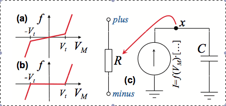

I can help you. But can you be a little more clear with simple circuit diagram and simple expressions?
Hi there, thanks for replying.
I've attached the circuit diagram as image.
PLEASE NOTE - I don't need help with the Model, I just need help with syntax. Thats the code I gave in my first post just needs its syntax tweaked so it is compatible with Pspice.
The research paper that I'm referring to states the following for the Spice model:
"SPICE model: The memristive devices with threshold that we consider are those described by
I = X-1VM
X ̇ = (βVM +0.5(α−β)[|VM +Vt|−|VM −Vt|])
where Vt is the threshold voltage, Ron and Roff are limiting values of the memristance RM ≡ X, and the θ-functions
Note - These equations are represented in ngspice code I gave in my first post.
- The important model parameters are the coefficients α and β that characterize the rate of memristance change at |VM|<Vt and |VM|>Vt , respectively.
- These two coefficients define the slopes of the f (VM) curve below and above the threshold. When α = 0, the device state changes only if |VM| > Vt"
Please let me know if this makes it clearer.
I appreciate any help you can provide here!
Many thanks again
CaptainKirk

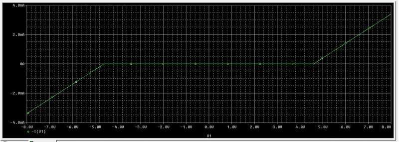

Here's your PSpice macromodel as requested. To use it in your circuit just copy the "* memres ... begins" to "* memres ... ends" portion to your circuit and call the model using "X(ref) (node1) (node2) R_MEMR PARAMS: VCUT=(param) ALPHA=(param) BETA=(param)" device card.
Code:
* memresistor model begins
.MODEL SWD D IS=1E-16 N=0.001
.FUNC GET_R1(ALPHA) {1/ALPHA}
.FUNC GET_R2_R3(ALPHA,BETA) {1/ABS(BETA-ALPHA)}
* ABS is given to prevent negative resistance
.SUBCKT R_MEMR 1 2
* Default parameters defined below
+ PARAMS: VCUT=1V ALPHA=0.1M BETA=0.2M
R1 1 2 {GET_R1(ALPHA)}
D2 1 3 SWD
V2 3 4 {VCUT}
R2 4 2 {GET_R2_R3(ALPHA,BETA)}
D3 5 1 SWD
V3 6 5 {VCUT}
R3 6 2 {GET_R2_R3(ALPHA,BETA)}
.ENDS
* memresistor model ends
*Test ckt
* The voltage source
V1 1 0 0Vdc
* The memresistor (new parameters are passed as arguments)
XMEMR_1 1 0 R_MEMR PARAMS: VCUT=4.6V ALPHA=0 BETA=1E-3
.DC V1 -8 8 0.01
.PROBE
.END
The test parameters I used are Vcut = 4.6V, alpha = 0, beta = 1e-3
The test result is in the attachment.
I simplified your expression as written below,
I = a*V for |V| < Vt
= a*V+(b-a)(V-Vt) for V>Vt
= a*V+(b-a)(V+Vt) for V<Vt
I could not model capacitance as you did not give its expression clearly.
