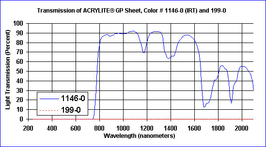

In contrast - the actual spectra is more complicated than they show. eg.
... see how the transmission bottoms out at short wavelengths? Remember that short wavelengths = higher energy.
Above a certain energy the energy band is basically a continuum in solids so you get a whole chunk being absorbed like that.
Get to a higher energy and different processes start to dominate - at very high energy you have matter and that just punches holes in things.
