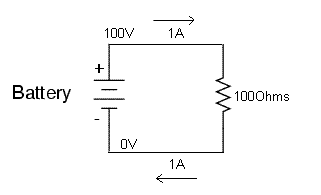

OK a very simple 1 resistor circuit ( same thing would happen for one of your light bulbs)
one side of the battery is 100V the other side ( the negative) is 0V that means there is 100V being dropped across the resistor.

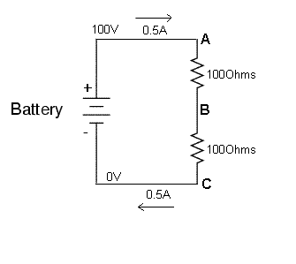

now a series circuit with 2 resistors...
With reference to the 0V line ( the battery negative terminal) what do you think the voltages are at point A, point B and point C ?
will give you a hint ... the 2 resistors are a voltage divider and because they are the same value its a divide by 2

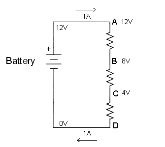

After the first resistor, voltage has dropped from 12 to 8 volts. After the second, it’s down to 4 volts. After the third, zero. "
OK, hopefully I have this correct. you comment infers 3 resistors...
so what can you see is happening to the voltage across each resistor ?
now using Ohms law V = I x R and knowing the voltage drop across each resistor and the current flowing in the circuit, we can work out the value of the 3 resistors.
Have you used Ohms law yet ?
Dave

in that last post we will compare that to the comment in your first post...
Which suggests you could have a bright bulb and then a dim bulb further on in the series when the voltage drops lower. But this is the opposite of what the first paragraph said.
no that's not a correct statement you have suggested.
look at that last post and imagine those 3 resistors are 3 bulbs, all identical 12V ones so they all have the 100 Ohms resistance shown in the diagram.
when you work out what the voltage is across each resistor, it would be the same as if they were bulbs.
1) how much voltage is each bulb getting ?
2) how much voltage are they supposed to get to light correctly?
3) if there is just 1 bulb and it lights to 100% brightness at 12V, how bright each would 2 bulbs in series be ( % wise) ?
4) how bright would each bulb be (% wise) if there were 3 bulbs in series ?
and the $6 million question for an extra 100 points ;) Why do you get these results ?

For the second post I think:

OK in my first post, second diagram with 2 resistors, you didnt take the hint
the 2 resistors are a voltage divider and because they are the same value, its a divide by 2
... at point B it will be 50V 100V divided by 2
if the resistors happened to be different values, then the value of the drop across each resistor would be different
You got points A and C correct :)
In my 3rd post, the one without the diagram, we subsituted the 3 100 Ohm resistors for 3 bulbs of the same resistance.
You should be able to see from the second post, with the 3 resistors that there is a stedy reduction of voltage from 12V down to 0V. Each resistor drops the voltage by 4 volts...
see the voltage readings at point A = 12V, B= 8V, C=4V and finally D=0V
So if you substituted the resistors for your 12V bulbs it means that each bulb is only going to see 4V across it rather than 12V so each of them is only going to be 1/3 (33%) as bright as what they would be if there was just 1 of them across the 12V supply.
AGAIN Note... they will all be the same brightness

Oh, I think I see what you mean for the second image. I took the current as 1A but that circuit can't exist unless it is 0.5A which makes each resistor eat 50V. I think the previous examples I mentioned can't exist in the real world then

Yes I have doubled the resistance from 1 x 100 Ohm resistor to 2 x 100 Ohm resistors and with the same voltage there will be 1/2 the current flowing.
I better sort out my other 3 resistor ones as well ! or... of you like you tell me what the current should be in the circuirt with 3 resistors :)
for working out the current flow just add up ALL the resistors for a total resistance and use Ohms law with the quoted voltage
Remember in a series circuit like this, the current will be the same wherever its measured in the cct
Dave
PS OK that's better :) the 3 resistor circuit is OK because we have named a voltage and current but in that cct we haven't named the resistances. You did work that out earlier to be 4 Ohms each
