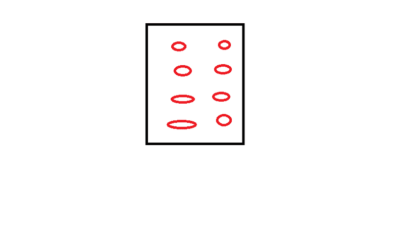

Sadeq
103
I'm very confused regarding this problem
and i will explain in it in details ,hoping anyone can explain the reason
For example we have a bolted connection subjected to torsion ,the bolts will have extra shear in the plane also when i strike a a slab of small building with lateral load(assuming torsion will be create ,because center of mass not equal center of rigidity) this will create torsion and make extra reaction on columns.However, when i put abeam fixed from two sides and make torsion in it this will not create extra reactions,so why!
I feel that i miss something,but can't find it
Please help
If my question is not clear please tell me
it just a concept question
i just need to understand the logic behind it
Thank in advance
A beam subject to torsion will have end reactions, satisfying the equilibrium equations. Perhaps you are envisioning a beam subject to a pure twisting moment ( a "couple") applied say at the middle of the beam. Call it "M". Then at each fixed end of the beam, there will be a reaction couple of M/2. There won't be any net vertical or horizontal force reactions at the ends, however, is this what you mean? Now if the connection at the ends each consisted of a 2 bolt connection, one bolt above the other spaced a distance "d" apart, then there would be a shear force in the top bolt equal to M/2d, and a shear force in the bottom bolt equal to M/2d in the opposite direction. The sum of those forces is 0 at each end, so there is no force reaction on the beam at either end. Is this what you mean?

Torsion moment will create to satisfy equilbrium in all cases.however shear force created at every element at beam section (all shears cancel togethor) so for this reason we design connection.
Iam I right
Thank you brother
My friend last question come to my mind regrading this why we calculate moment for inertia only for bolts.I guess the answer ,because it resist the shear only why plate don't.
Right!

Another simple question came to my mind, for example those nails in picture attached subjected to shear, so according to equilibrium they will be subjected to vertical shear and in paper force(Do we calculate in paper force??) also when we have plate with bolts subjected to shear it will have plane shear and, tension(so why we don’t calculate tension).Also in concrete beam ,we put stirrups for vertical shear so what about longitudinal shear that come from equilibrium(no reinforcement)

Sadeq said:
Thank you very much.
The nails (properly sized and spaced) transfer the longitudinal shears between the vertical and flat sections so that the beam acts as if it were one whole section. Longitudinal and vertical shear stresses at any given point in the beam's cross section
must coexist for equilibrium and must be equal in magnitude. The shear forces in the nails spaced a distance s apart are calculated from the shear flow equation (VQ/I)s .

Sadeq said:
Unfortunately I didn’t get the idea will(so please simplify it). As I understand the nail is subjected to vertical shear and also to longitudinal shear, so I should design for their resultant!
Thank you brother another time
No. Longitudinal shear only (into the plane of the 'paper') in the nails. Vertical shears are carried by the wood.

I'm very sorry i took a lot from your time, but believe me i feel that I am still misunderstand something, when you lock at rectangular section of steel,their will be shear longitudnal and verical equal in magnitude because of complementry property of shear stress.That what i know, the same here when i lock at fastenesrs,there should be both,but swood take vertical shear . Right!
SO, IF I have like the picture which illustrate plate and bolts , who will take the longitudnal shear.?

We seem to have strayed a long way from torsion, haven't we, bro? Anyway, complimentary vertical and longitudinal shears aren't even in the same plane...don't try to combine them! Let's forget the nailed section and look at a solid section b x h with a vertical shear force of V at that section. I is bh^3/12, Q max at the NA is bh^2/8, and the transverse shear stress at the NA is VQ/Ib = 1.5V/bh. There is also a longitudinal shear stress of the same value that acts along the longitudinal axis of the beam. But you don't design the beam for both stresses, just one will do, OK??

If you have a beam that is bending and twisting at the same time, you must design for bending stresses as well as both vertical and torsional shear stresses (they all act on the same plane). If you have a beam subject to bending only due to applied vertical forces, you must design for bending and complimentary vertical and longitudinal shear stresses (those shear stresses act on different planes).
