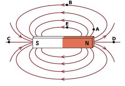

say we base the motor on this type were the coil is out side and the rotor is in the center
see attatched pic..
on the second pic (best i could find to show the field) picture the magnet as the spining motor C & D.
on the field A, E & B what's happening to the field in relation to north and south, dose it flux n,s,n,s,n,s up the length of the coil to the center of the motor, Or is it a constant n,s to the center of the coil.
basically What am trying to find out, is the field as strong on the out side of a coil as it is in the center of the coil. Could this spare magnetic field be re - used
