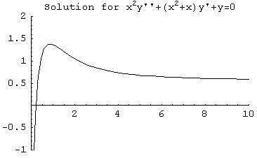

Using StatusX's method, I worked the equation from scratch and obtained a different answer than he (generator function is different). Using Mathematica, I calculated the first 50 terms of the series, calculated the first and second derivatives and back-substituted into the ODE in the range (0.1,10). The results were no greater than 10^-12 which give me confidence the solution is correct for the first function. The results also agree with numerical results using NDSolve. I've included a plot of the solution in the "attached files" section.
[tex]x^2 \frac{d^2 y}{d x^2} + (x^2 + x) \frac{d y}{d x} + y = 0[/tex]
[tex]y_1 = a_0 x^i (1 + \frac{i}{1+2i} x + \frac{i-1}{12i-4} x^2 + ...)[/tex]
[tex]y_2 = b_0 x^{-i} (1 + \frac{-i}{1-2i} x + \frac{-i-1}{-12i-4} x^2 + ...)[/tex]
The generating equations for each coefficient are:
[tex]a_n = \frac{1-n-i}{n^2 + 2ni} a_{n-1}[/tex]
[tex]b_n=\overline{a_n}[/tex]
with overline being the complex conjugate.
As per StatusX, letting:
[tex]y_a=y_1+y_2[/tex]
[tex]y_b=-i (y_1-y_2)[/tex]
and
[tex]a_0=b_0[/tex]
the following expression can then be defined for the first function:
[tex]y_a(x) = \sum_{n=0}^{\infty} y_n(x)}.[/tex]
The first five functions for yn:
[tex]y_0(x)=2a_0 Cos[ln(x)][/tex]
[tex]y_1(x)=\frac{2}{5}a_0 [-2Cos[ln(x)]+ Sin[ln(x)]]x[/tex]
[tex]y_2(x)=\frac{1}{10}a_0 [2Cos[ln(x)]-Sin[ln(x)]] x^2[/tex]
[tex]y_3(x)=\frac{1}{390}a_0 [-17Cos[ln(x)]+6Sin[ln(x)]] x^3[/tex]
[tex]y_4(x)=\frac{1}{624}a_0 [5Cos[ln(x)]-Sin[ln(x)]] x^4[/tex]

wow, great work saltydog. That plot is especially interesting. I need to figure out how to use those programs. and by the way, i did copy those coefficients wrong, there should have been an i on top.
So I guess we found out that imaginary powers do work, and they give two conjugate solutions which can be easily manipulated to get real answers involving sin(ln) and cos(ln). I'm curious if anyone knows what kinds of functions will result in these solutions. Also, is there a connection between imaginary frobenius solutions and Fourier transform solutions?
Dude, you have got to start using Mathematica! And I probably learned more than you. Thanks for working with me. I would never have proceeded to completion, the insertion of i and -i into the series without your work showing so. Maybe someone here can answer your questions. They're interesting but I don't know the answer.
