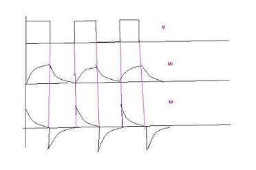

The scans are small for some reason, but here they are.
Questions[/URL]
The graph is the first one, and the second two are for me to write in.
Below is what I think it should be
[PLAIN]Answer[/URL]
The first one is VC, the second one is Vr and the graph has the interval +vo to - Vo

The questions image came out OK, it was what I expected.
The answers image didn't come out so clearly, but I'm afraid it's quite obviously wrong, it doesn't have the right "shape" at all.
Here's what the answer should look like. My artwork is terrible, but you should get an idea. In case the captions are difficult to read, the top one is the total voltage (square wave), the middle one is the voltage across the capacitor, the bottom one is the voltage across the resistor.
