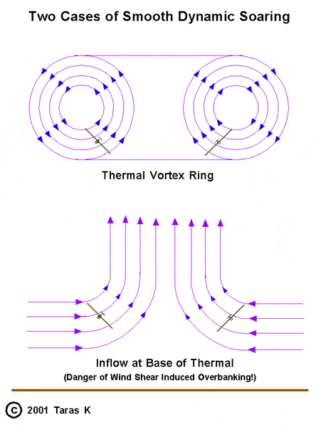

http://www.icarusengineering.com/Dynamic-Soaring-and-SE.htm
I am trying to validate dynamic soaring versus normal thermal soaring, but both are using thermals as the power source. Dynamic soaring would mean using 2 types of air masses. One in the thermal and the second one is the inflow to the thermal.
I'm thinking that the shear boundary layer between the inflow and updraft of a thermal is too large and the differential in air mass speed too small to be useful for dynamic soaring in the conventional sense.

From: http://www.icarusengineering.com/Dynamic-Soaring-and-SE.htm
That's not quite the idea behind the smooth DS that you linked. In fact it uses only the inflow to the thermal. Keep in mind that the air on opposite sides of the inflow is moving in opposite directions horizontally, so you already have the velocity difference that you need for DS. You don't fly into the center of the thermal, just circle around it, and use the horizontal velocity difference.

One aspect of dynamic soaring that hasnt been well covered in this thread and some of the links is the fact that a glider crossing a shear boundary into a relative headwind doesn't increase it's energy relative to the ground.
That is true. The kinetic energy relative to the ground is increased when it makes a downwind turn within an airmass that moves relative to the ground. It accelerates the air in the opposite direction, slowing it down relative to the ground, and thuse extrating energy from the true wind. But to do this continuously you need a second airmass with a different velocity, so the energy gain is not reversed again when you turn in the opposite direction.

At higher altitude, such as shown in the video, there probably isn't much inflow into the thermal other than shear effect. So the two air masses are the upflow at the core and somewhat stationary air surrouding the flow. So a model could dive into the thermal from outside the thermal, then do a partial upwards loop while in the thermal. The point of my previous post is that the model needs to enter somewhat downwards, then turn (partial loop) upwards in the direction of the air mass in the thermal, to gain energy from the thermal. In this case, the model is able to achieve higher speed by maintaining average altitude instead of using the thermal's energy to increase altitude.
