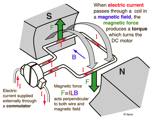

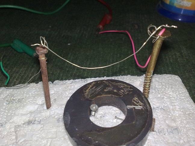

A picture I included shows how my motor is constructed. The basic science fair project looking engine. This engine is actually designed to do work, however, it will not turn over once DC is connected to it.
The wire is close to 5/64 inch thick and the whole rotor is solidly soldered together. I had a heck of a time finding Magnets for the thing and finally found a circle magnet form a CB radio antenna. I was able to see some movement when 4 C cells were used as power, but no rotation was able to be achieved.
What have I done wrong folks? Thanks for you're help if you help me ;)

Flyingwing12, Welcome to Physics Forums!
If your motor doesn’t rotate then there is some mistake in the construction or electric power connection (or both). You may compare yours with these to find the error:
Your drawing looks a lot like this one:
"How to build a simple electric motor":
http://www.hometrainingtools.com/build-motor-project/a/1605/
Magnet Motor Kit:
http://www.miniscience.com/projects/magnet_motor_kit/index.html\
Hundreds of photos and images of simple dc motors:
http://www.google.com/search?q=simp...gG93YDQBQ&sqi=2&ved=0CFEQsAQ&biw=1223&bih=619

Can you post a picture of your setup?
Wires melting is clearly a problem. Either use lower Voltage or huge thinner wires.
Your design is also not good one. Using Coils would allow you to have much more torque by flowing little current. Also wire melting problem can be mitigated because, the long length of wire will reduce current flow.
See Post #3 links, by Bobbywhy.
Here is a picture of the motor. I chose this design because it shows the beauty of movement! All of the other designs are small and compact which don't interest me.
Everything on the rotor is SOLDERED together. The tape is just to protect my hands form the pointy protrusions

See the basic theory
F ~= B*N*I*L
In your case no. of turns N = 1.
Lots of design use at-least N = 15-20.
So, you need to compensated your N=1 by increasing I by 15-20 times, provided you use magnet (B) of same capacity. You seem to be using alnico magnet, which isn't as powerful as neodymium magnets.
The wires seem very sturdy, I don't think it melts with 8-10A. How long did you let it on?
The only thing you could do is increase the current even more.
But you need to make really sure that the support is friction free and the thing can rotate even with slight force.
Once again, design change is what I suggest. You could easily scale up the 'compact' design.

a number of problems some of which I_am_learning referred to
one other is the magnet ... not what the manget if made of ... ''You seem to be using alnico magnet, which isn't as powerful as neodymium magnets.'' that I_am_learning also commented on, that's of least importance and your problems.
The big problem is the shape of the magnet and its orientation to the coil. You cannot use a single magnet in the way you have shown
Look closely at the drawing that dlgoff showed in his post above and particularly note that the coil sits BETWEEN the N and S poles of the magnet
The single turn of wire as you have will not work ... although you may think you have multiple turns, you don't they are just single strips of wire in parallel with each other.
You need an actual coil of wire with multiple turns that starts at one side of the upright and goes through to the other side/upright
You will be able to make it work that way which is a variation on that drawing that has bother end of the wire coil coming out the same side

Flyingwing12, before we go on I would ask you if you know what a commutator does.
I know that it switched the current direction, right?

Hi Flyingwing12. I have a lot of time for experimenters, being one myself, so it's interesting to see how you are going about the design of a model motor. You will learn a lot from this. As other have pointed out, there may be two problems: the magnet, and the rotor. :smile:
To see whether you stand any chance of getting movement. disconnect power from the rotor but leave the rotor there, no need to move it. Now, between those wooden blocks temporarily sling a single length of flexible copper wire horizontally above the magnet—this will be like a simplified rotor. How to suspend it? Hang a short length of string from a drawing pin on each block to suspend the wire so it's free to swing up/down/sideways. This moveable wire will reveal any repulsion between it and your magnet when that wire carries current. Do you have some means to limit the current, as a thin piece of wire is likely to overheat and melt. Perhaps connect a 12v car headlight globe in series, if your only power source is a car battery.
Should that single wire show no inclination to move when powered, then you are wasting your time trying to get your more elaborate "eggbeater" rotor to spin. It will be time for a rethink.

You really need a commutator. Suppose with a single loop of wire the current is split evenly through the upper and lower loop. In order for the rotor to turn the upper wire has to move in the opposite direction of the lower wire. One wire will fight the other. Remember the right hand rule when it comes to magnetism and current flow? The reason your single loop worked at all is because the field was small enough on the top compared to the bottom so the lower 'outpulled' the upper.
