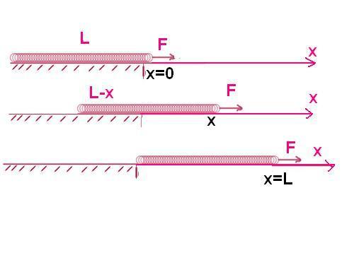

A heavy chain with a mass per unit length ρ is pulled by the constant force F along a horizontal surface consisting of a smooth section and a rough section.The chain is initially at rest on the rough surface with x=0 .If the coefficient of kinetic friction between the chain and rough surface is μ , determine the velocity of the chain when x=L .
I am applying work energy theorem . Work done by constant Force will be Force × displacement of centre of mass i.e FL but not able to find work done by friction .The friction force at an instant when chain length x lies on the rough surface should be μρxg.This force is continuously decreasing .i feel calculus is involved here but i am unable to apply it.Please help me .thanks.

The force of friction on chain is μN ,where N =(mass of chain on rough surface) ×g=ρxg.Thus frictional force at any instant when chain of length x is on rough surface is μρxg.But now as the chain is being pulled to right ,the length x decreases , hence frictional force decreases continually.Now i am not able to calculate the work done by this variable frictional force .What should be the limits of x when we consider dx displacement.Please reply...

You got the force of friction right. Find the work done by force of friction for small displacement dx. Integrate it from x=0 to x=L.
why integrate from x=0 to x=L.This is the portion on smooth surface.
Yes, it is. We have to find the work done by the force of friction when x=L i.e. L length of the chain is on the smooth surface now.
hey Pranav...please can u give a detailed explanation.thanks. i feel limits should be between length and length - L coz intially length (full chain)was on rough surface and finally L moves to smooth surface so length - L remains on rough surface so technically we should integrate between the limits length to lenth - L.Plz help.
What is the total length of the chain?
I made assumption length=L.
The force acts at the right end of the chain, and the displacement of that point can be called x. x changes from zero to L, length of the chain. If the right end is at position x, L-x long piece of chain is on the rough surface. The force of friction, as you wrote correctly is proportional to the length on the rough surface. So the total force is Ft=F-μρ(L-x)g. The work of the total force is
[tex]W=\int_0^L{F_tdx}=\int_0^L{\left(F-\mu \rho g (L-x)\right)dx}[/tex].
L is not specified as the length of the chain. Nor is that apparent from the original drawing. Am I missing something?
Ops, you are right. But it seemed plausible that L is the length of the chain. Now, if it is Lc, than the work is the integral above for L≤Lc and ∫Fdx from x=Lc to L. But one does not know the mass of the chain as you pointed out, and the problem can not be solved.

You are right, L should be the length of the chain...
