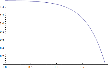

Here is a numerical solution for a frictionless hatch with finite angular momentum. θ(t)

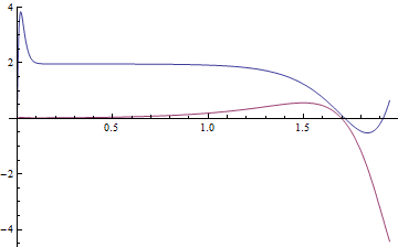

Fx(t) (red) and Fy(t) (blue)
As you can see, the constraint switches from pushing to pulling right before the hatch slams shut. (The initial spike in Fy is due to settling in simulation.)

K^2 said:
Yes. You are not working with constraint forces properly. The constraint is doing more than supporting the weight of the hatch. As the result the constraint at the hinge will depend not only on angle the hatch makes, but also on velocity and acceleration.
You're right - I missed the centripetal force.
