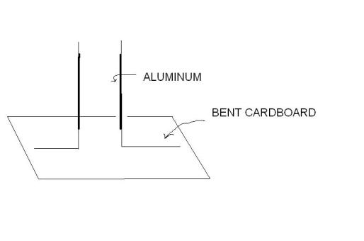

I want to make a parallel plate capacitor without dielectric between it, that is, a capacitor with free space.
Can I do a working capacitor with just a two parallel cardboard coated in aluminum? I figured it should look like this:
Also, if there's anyone who's got a better idea on how I could make this, I'd really appreciate it if you could share that.
To get yourself a measurable amount of capacity, the plates need to be close together and have a large area (also the cardboard may not be a good insulator).
It may be best to use your two bent sheets of aluminium (nice and rigid and flat) and hold them with four nylon screws and nuts, with one or two nuts as spacers. You can then adjust the capacity by altering the number of nuts/spacers. If you can't get access to a drill, some thin blocks of plastic could be stuck to the plates but make sure you have the plates well insulated so the glue must not bridge over the insulating plastic spacers.
You mean I'd connect two aluminum sheets together directly by using nylon screws? Sorry, I can't quite visualize that, I'd be very thankful I you could provide an image with that. I'm sorry if this sounds so imposing.
The sheets need a small gap between them. I was suggesting a nylon nut (or two) in between them, to keep them apart. Thus:
Nylon screw head - plate - nylon spacing nut - plate - nylon nut (at each corner)
If the plates are reasonably thick, the single nut spacing should keep them far enough apart to allow for any small amount of bending of the plates
If you use four screws (near the corners) the arrangement would be nice and strong. Of course, you need to avoid the thing flexing and causing a short between the plates so thick(ish) metal would be appropriate. Solder lugs could be attached to the plates using the nylon screws too, to make a good connection. (Don't solder them whilst in place or the screw will melt!). Is that description better?

Yes, it is, thank you. I basically need nylon screws (which I think are really good insulators) to put the two plates together.
Another question, are aluminum foils (this is what I have at the moment) the optimal, cheapest, and most convenient conductor for this kind of set up?
As embarrassing as it is, I'm not sure what voltage reading is high or not but I'm planning to use something that generates not more than 12V.
Also, will I be able to slip a dielectric inside? What I'm actually planning is to read the voltage (potential difference) of a capacitor in free space and one with a dielectric.

What experiment do you actually plan to do? If you connect 12V across your C and look with a multimeter, then the voltage will drop pretty quickly when you disconnect your 12V. (I doubt that you could tell the difference with an without the C, aamof because the time for the volts to drop to 1/e of start volts is RC. C, in this case will be no more than, perhaps 1000 pF (10e-9F) and the resistance of your meter will be, say 10e6Ω. That is a time constant of 10e-3s.
This design of Capacitor is more suited to gathering charges which have been built up electrostatically and then producing small sparks with high voltages.
Adding a (commonly available) solid dielectric won't increase C by more than a factor of 5 so that won't help you.
This is one of those times when the actual values count if you want a result. For a parallel plate capacitor, the formula for C is
c= ε0εrA/d
which means it's proportional to area and inversely proportional to separation.
The thing about Capacitors is that they have to try quite hard to make them with values that are 'useful' for this sort of (low frequency) application. If you want a high enough value of capacitance for your purpose then the way to do it is using a sandwich of aluminium foil and 'cling film', rolled into a 'swiss roll'. Several metres of the sandwich, combined with the small gap which the cling film provides perhaps 1000times the value of your design. (You get a doubling of the area too! For free! This should give a time constant of about 1s, which will allow you to watch the volts drop at a sensible rate.
Just imagine the trouble they have to go to to produce a 10,000μF capacitor!
