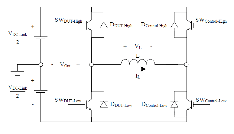

I have a single phase DC-AC inverter (or H-Bridge) with an inductive load
I want to design a controller that controls the PWM signals to the control side switches that will ensure there is a sinusoidal current through the load. I need to use PI control and implement into a DSP so it has to be a discrete (z-domain).
I am really struggling with this. I have an understanding of how a h-bridge works but little control knowledge. I know the transfer function of the inductive load is:[itex]\frac{1}{sL + R}[/itex]. and I know I will have a reference current (which I want to the output through the load) and a measured current that I will feedback into the start to calculate the error.
If anyone has any tips or tutorials in this I would greatly appreciate the help

The transfer function is not just the inductor, but also the H-bridge switching. Is this for a motor?
No its just an inductive load, I'm using it to simulate one leg of a full 3 phase inverter so I can test the efficiency of the MOSFETs
I think I have done the transfer function and the controller. The transfer function was the load and the gain of the bridge (Vdc) and an exponential term for the delay as it is implemented discretely.
It works for below 10Hz but not for 50Hz which is what I want. I think I have to do something with the phase displacement (see attached bode plot), as I think that the error being calculated is wrong if there is 20degrees phase difference between reference current and the output, any ideas?

Hello Bakez -
There are H bridge controllers on a chip - but I think they are all for a "direct" inverter, in this case Fout = Fsw. Typical for DC-DC converter. For motor control - esp 3 Phase, I have not found any "Controller IC" to do this. They are ether DSP or FPGA and the - TI has a wealth of info on this - and they have a library of software to help (try this : http://www.ti.com/tool/TMDS1MTRPFCKIT ).
Starting with an "H" bridge model and converting to 3 phase is not simple - you are ether running 3 x the H bridge ( 12 PWM Signals ) I have only seen this is special application - or the 6 Switch 3 Phase inverter - where - Say Phase A TOP is at the top of the sine in current - Phases B AND C Bottom switches are each carrying 1/2 of the current of Phase A - so the relationships between each switch are much more complicated.
There are a few things you need to implement current control:
a) current sensor in line with inductance
b) gate driver for each switch
c) pwm generator and mcu to perform calculations
There are three basic modulation methods of driving an H-bridge: unipolar modulation scheme, bipolar modulation scheme and the other is called phase-shifting modulation scheme.
In the first method just one side of the bridge is PWM modulated. The other side is either tied high or low to enable bidirectional current flow. This method applies half the rms voltage across the inductor as opposed to bipolar modulation (inductor voltage is either +Vdc or 0 provided the second leg is tied to ground)
Bipolar modulation method makes the two legs complement each other. If the left leg has duty ratio D, the right leg will have duty ratio D'.
Yet another method is to phase-shift the two legs. Each leg has fixed duty ratio of 50%. Inductor voltage is caused by a phase shift between the two legs.
Gain calculations of the current pi controller is quite simple.
Choose your crossover frequency, which should be 1/10 or less of the switching frequency. Since you have an inductive element (energy storage) and your PI controller also stores energy, you have a second-order system. Make sure that your phase margin is at least 45 degrees, 75 degrees is even safer. This will give you good damping.
PWM pulses and calculations can be done in a cheap MCU such as PIC16F1937 -- you can check out this devkit - http://www.digikey.com/product-detail/en/DV164132/DV164132-ND/2332783
Source: power electronics & controls engineer

Okay, let's go back to the linear system theory:
Non-ideal inductor duty ratio to current transfer can be easily found out using basic Kirchoffs:
By averaging:
[itex]v_{dc}.d = v_{l} + v_{r}[/itex]
Linearize:
[itex]v_{l} = V_{l} + \tilde{v_{l}} \\<br /> v_{r} = V_{r} + \tilde{v_{r}} \\<br /> v_{dc} = V_{dc} + \tilde{v_{dc}} \\<br /> d_{} = D_{} + \tilde{d_{}}<br /> [/itex]
Let's plug linearized relations into the averaged equation.
[itex]V_{dc}.\tilde{d} + D.\tilde{v_{dc}} + D.V_{dc} + \tilde{d_{}}.\tilde{v_{dc}} = V_{l} + \tilde{v_{l}} + V_{r} + \tilde{v_{r}}[/itex]
Steady-state part is:
[itex]D.V_{dc} = V_{l} + V_{r}[/itex]
Where the first term on the right side is zero, which corresponds to the theory (inductor is short at DC)
Perturbation part:
[itex]\tilde{v_{l}} = s . L . \tilde{i_l} \\<br /> v_{r} = R_{l} . \tilde{i_l} \\<br /> <br /> \frac{\tilde{i_l}}{\tilde{d}} = \frac{V_{dc}}{s.L+R_{l}}<br /> [/itex]
Hence you need to compensate this transfer function.
With switching frequency of 2.5 kHz I would suggest to choose 200 Hz crossover frequency. Current command performance might not be acceptable in which case you could switch to control is rotating frame (DQ current command). But that is quite involved.
With regards to inductance selection, 500 Vdc and 2.5 kHz will indeed require large inductance to keep the current ripple to 20% or so -> 15Arms = 21Apk -> 2.1Apk ripple current is allowed.
I would suggest increasing the switching frequency to about 15 kHz and using larger inductance as you say. You can always put more inductors in series to increase the inductance. Such slow switching speed is common for large systems which push hundreds of amperes so that a 50A ripple current is acceptable.
A while ago I did a similar project - Vdc = 400V, Iout = 3A, fsw = 50 kHz, L = 4.7mH * 2 (Pi filter). Also, don't forget that you should have a PI filter at the output to filter out harmonic components. Current can be measured at either point.
