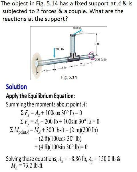

What are the reactions at the support? (momentum)
The discussion centers on understanding the signs in the torque formula as presented in an online course. A participant seeks clarification on the direction of torque related to a 200 lb moment at a distance of 2 ft. The conclusion drawn is that the negative sign indicates the torque acts in the opposite direction. This highlights the importance of correctly interpreting signs in torque calculations for accurate problem-solving.

I am taking this course online, and in one of the slides there is this example, but i can't figure out the signs in the momentum formula.
THANKS!
so here is the exersice:
It's not immediately clear to me just from the diagram what the direction of the couple (torque) is supposed to be at the end of the object, but given that they put a negative sign on the 2ft, 200lb moment (not momentum), I infer that the torque is in the opposite direction than that.
