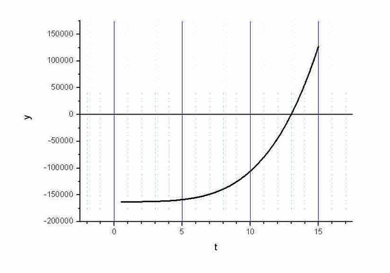

It is an equation to do with population growth it asks approximately when (t- time in years) will population(p) be 175 000
I honestly can't figure it out this is far as i get
p(t)=6t^4-5t^3+200t+12000
175000=6t^4-5t^3+200t+12000
0=6t^4-5t^3+200t-163000
I honestly don't know what to do i am lost, I'm sure its not that complicated but i just would love some help.
Thanks in advance!:)

I don't think it is going to factor nicely. Notice the question asks for approximately the value of ##t##. I would suggest trying a graph for a first approximation, which may be good enough. Or it would give a starting point for Newton's method if they are studying that. But there is an integer value of ##t## that gives a very close answer.

Alright. Were you saying that to solve for the approximate I would just keep subbing in numbers until I got aprox. 175000. If so this seems very inefficient, are their any concrete and less exhausting ways to get the answer?

I would think for a problem like this a graphing program or calculator or a web page that does graphs would be appropriate for starters. So, no, I wouldn't (and didn't) graph it by hand.
Here is a plot of 6t^4-5t^3+200t-163000.

I'm not good at this, so could someone explain whether using Picard's method can get the solution fast enough?
What do you mean on Picard's method?
Try to apply the iteration in post #8
Start with y1=20: y2=13.5, y3=13.02, y4=13.00
