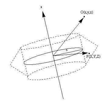

I see. I don't think that the geometry here is so important, as I get similar results for square cross-section. I will append a few pictures for better understanding of the geometry.
The first picture shows you, how the coordinate system is set. The point inside a torus has coordinates (X,Y,Z) and I change them in into cylindrical, as described above, as it is easier to integrate over torus then. The point outside the torus, where the imaginary object is, has coordinates (x,y,z) and I do not put them into cylindrical coord., as it is easier to calculate the acceleration in the cartesian coord.sys.
The second picture shows the xz plane - the mentioned cross-section of the torus.
The third picture shows, how the torus looks.

You should use cylindrical coordinates for the outer space, too. Why? Because the potential energy is axisymmetrical here, so it won't depend on ## \phi ##. This means you can represent the vector to the orbiting body this way: ## \mathbf{r} = r\mathbf{e}_r + z\mathbf{e}_z ##, where ## \mathbf{e}_r ## and ## \mathbf{e}_z ## are unit vectors along the r and z coordinates. Then if you do the math, you will get [tex] \ddot{r} - r \dot{\phi}^2 = - \frac {\partial U} {\partial r}<br /> \\ 2\dot{r}\dot {\phi} + r \ddot{\phi} = 0<br /> \\ \ddot{z} = - \frac {\partial U} {\partial z}[/tex]The first two equations are very similar to the equations of "normal" two-body problem, except that the potential energy term is different. The second equation is in fact the area law, ## r^2\dot{\phi} = const ##. The third equation is the harmonic oscillator. You also have conservation of energy for the entire system.
What I think you should do is the find the minimal points and curves of the potential, linearize the potential in the vicinity of the those locations, and solve the equations of motion with the linearized potentials.

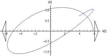

I am unsure how you could get non-constant energy trajectories. The force is potential, so energy must be conserved.
As for the negative energy. Consider the orbit where z = 0 and R = const. Is that a possible orbit? It seems it should be, given the symmetries in the problem.
Yes, I have found an orbit like that, but the professor also advised me to look for the orbits, that go around the torus like a ring (xz plane) - to compare their energies. But my trajectories always go around the whole torus.
Edit: I attached a file of an example, that seems pretty illogical to me. I deliberately started on the inner side of the torus, to "force" the trajectory to go over the triangle, but it went the other way ... or is there something wrong with my understanding?

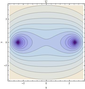

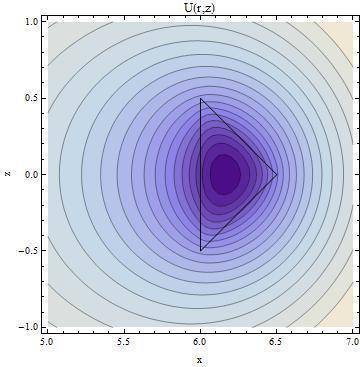

Have you tried to plot the potential? What does it look like?
Potential in xy plane are concentric circles, potential in xz plane looks like this ... (the second picture is zoomed and shows, where the torus is located)

In the xz plane, due to the symmetry, you could treat the problem as 2D (forces in the y direction should cancel out). Then what you would have is a special kind of the three-body problem. It goes by many names, one of them is the problem of two fixed centers. This problem is known to admit closed orbits only when initial conditions are specially selected, otherwise the trajectory fills some portion of the plane densely. It is also known that motion about just one center is possible (which should be intuitively clear, as the Earth - Sun system can be regarded as an example of two fixed centers).
