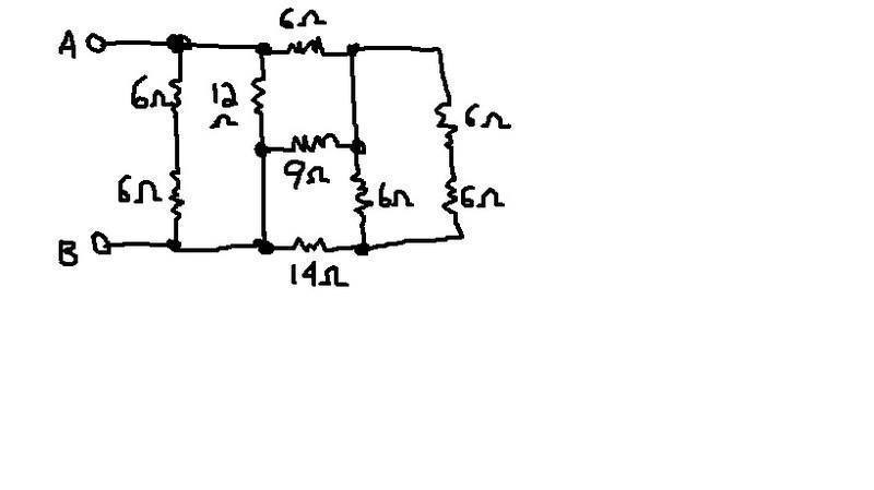

Find R_AB in the network. Look at attached file "Problem"
R_S= R1+R2+R3+...Rn (for series resistors)
1/RP= 1/R1 + 1/R2 + 1/R3 + 1/Rn... (for parallel resistors)
V=IR (ohm's law)

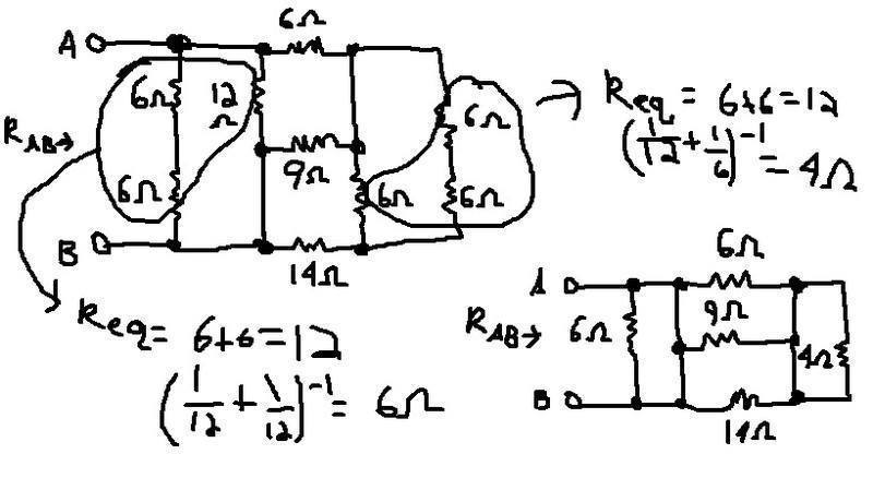

Look at attached file "Problem Attempt"
I know I'm probably not looking at these circuits the correct way, because each time I try to solve these problems, I find different equivalent resistances depending on the order by which I use the series resistor and parallel resistor formula. I really want to know the correct way to read the diagram, because that is half the battle, and it would guide my calculations a lot more smoothly.
I'm also stuck. What do I do with that 9ohms?

4 ohm and 14 ohm resistors should be in series. Redraw your sketch.
