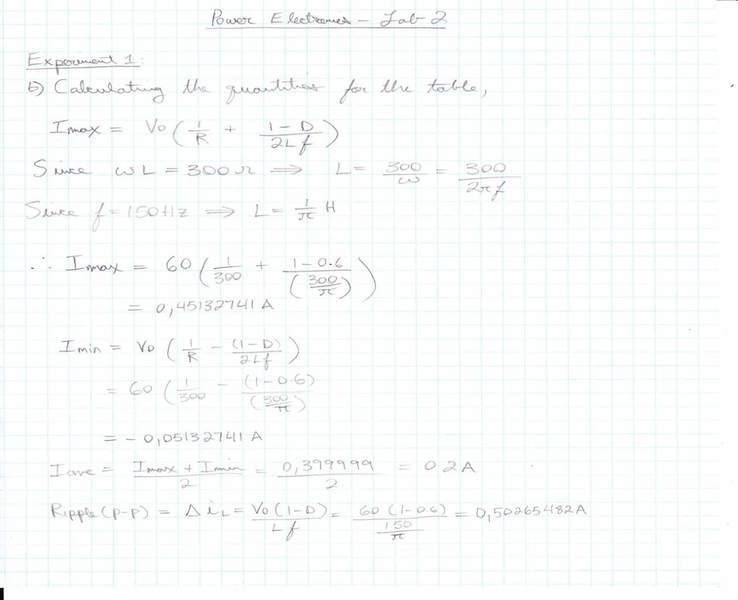

Hello all,
I recently did a lab on buck converters and I have a couple a questions.
See the figures attached for lab and my work.
For Experiment 1:
The measured quantities for part b) were,
[tex]I_{ave} = 0.2A \quad I_{min} = 0.09A \quad I_{max} = 0.28A \quad Ripple_{pp} = 0.19A[/tex]
These values differ slightly from my theoretical calculated values, did I make any mistakes or are there any discrepancies?
Also, the Imin I calculated was negative, is this a problem? Also, I'm not sure if I am correctly the average current correctly, can someone verify?

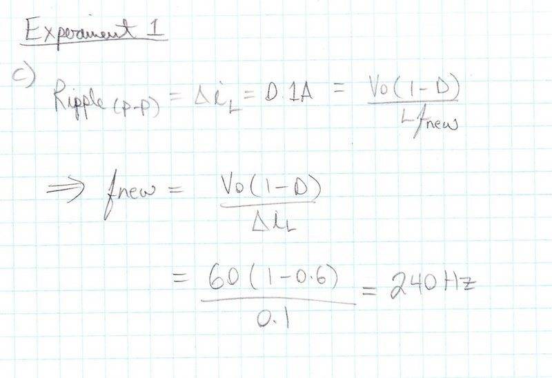

The new switching frequency we measured for part c) was,
[tex]f_{swnew} = 300Hz[/tex]
The theoretical frequency I calculated was 240Hz. Is this a large discrepency? Did I make any mistakes in the calculation?

For Experiment 1,
In part b) we dialed the frequency to 150Hz and measured the values in the table, the measurements we observed are in my original post. I then calculated the theoretical values (see 2nd figure attached), which slightly differed.
In part c) it says to adjust the frequency to obtain a ripple of 0.1A, the observed measured frequency was 300Hz, but when I did the theoretical calculation (again, see 2nd figure attached) I obtained a frequency of 240Hz.

And you say you are worried about your Imin being negative, but you show Imin = 0.09A. Can you clarify that please?
because that Imin is the value we measured in the lab. If you look at the 2nd figure attached that contains all my work for calculating the theoretical values, where I had solved for a negative Imin. (-0.0513A)

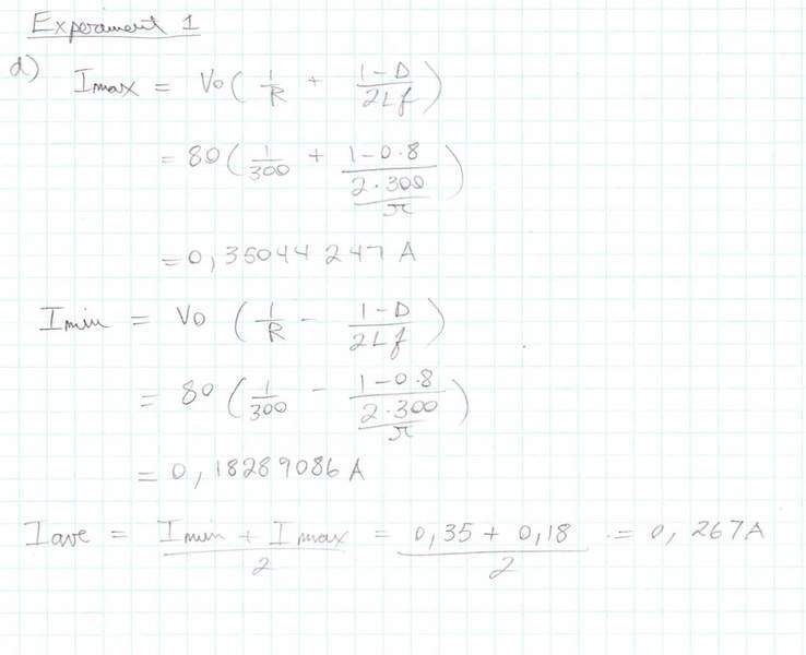

Sorry, I'm not able to read the 2nd attachment. Maybe that's part of my confusion.
Can you do a higher resolution scan of your 2nd attachment? Or maybe take several pictures closeup of different parts of it...?
Here is all my work attached, parts b), c) and d).

berkeman are you still checking in on this thread?
I've worked out all the details regarding the calculations for Experiment 1, but I am still curious as to why we did not observe any oscillations on the shaft speed of the motor.
