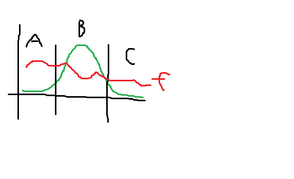

Our goal is now to pick an interval around the mean np, which includes an increasing number of standard deviations around the mean as n goes to infinity (which means the interval covers an amount of probability that goes to 1), but where the interval also becomes a smaller proportion of n as n goes to infinity (which means the interval includes only values from a small local part of f). Then we can show that the sum can be approximated only by values from within this interval, and provide converging upper and lower bounds for the sum within the interval.
Here's a picture of the interval (labeled B) and the parts beside it (A and C):
The variance of the binomial distribution is np(1-p), for a standard deviation of [itex]\sqrt{np(1-p)} = \sqrt{n} \sqrt{p(1-p)}[/itex]. So the size of the interval must grow faster than [itex]\sqrt{n} \sqrt{p(1-p)}[/itex] in order to include an increasing number of standard deviations around the mean. It must also grow slower than n, in order to decrease relative to n. So by picking any function asymptotically between [itex]sqrt{n}[/itex] and n, let's choose the width of the interval to be [itex]2 n^{2/3}[/itex]. We want the interval to be centered about the mean, and since it's used in the sum the endpoints must be integers, so that gives us [itex](\lceil np - n^{2/3} \rceil, \lceil np + n^{2/3} \rceil)[/itex]

Now you must prove that L = f(p). First, since [itex]A_p(n)[/itex] and [itex]B_p(n)[/itex] go to 0 as n increases, the first and third parts of the sum go to 0. Second, [itex]B_p(n)[/itex] goes to 1 as n increases (due to careful choice of the interval, earlier). And third, f is continuous, so [itex]B_{fmin}[/itex] approaches f(p) as the interval shrinks around p.
In a similar fashion you prove that U = f(p). Then since the limits in U and L sandwich V from above and below, you can conclude V = f(p).
