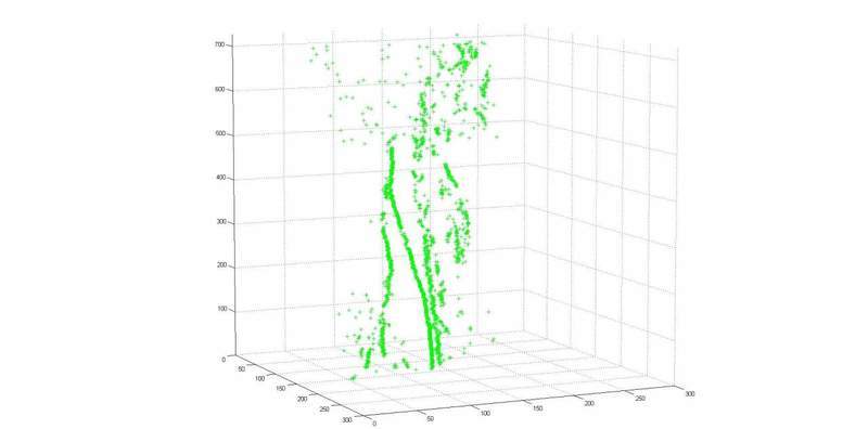

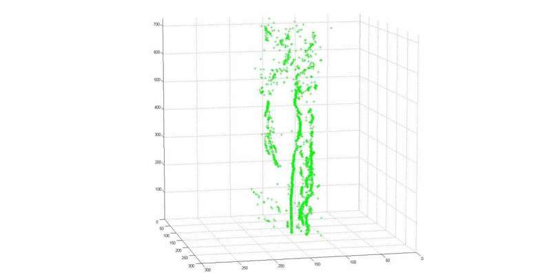

I am wondering if there is any way to create a model that can be used in a RANSAC method where a spline could be determined from a noisy 3d point cloud.
What i have is a volume containing a set of points in each xy-plane, having say 400 of these in the z direction and a spline shape emerges visually while simply looking at the plotted data in 3d space. I already have a line fitting RANSAC scheme where the error is determined by a simple distance measure but i can't get my head around how to determine a model for a spline.
I am unsure if I am posting at the right thread so if I am at the wrong place please refer me to the right place :)

Thanks for the replies.
Stephen:
It is lines i mean by saying "spline shape" visually emerges. I have two pictures of the same point cloud just rotated. Sorry that its hard to see but without any illumination its hard to illustrate depth.
Chiro:
Thanks that says a lot, i have totally forgotten the linear algebra stuff that i learned a while ago. Ill give this a go but i am unsure of what criteria i should imply while testing the rest of the data against a spline model. Just by measuring distance to the spline might be insufficient. Also i think i should use some gradient measure that looks at the slope of the spline, since as it can be seen in the pictures the most prominent spline is not very tilted.

You could also try doing smoothing over the points using a polar co-ordinate basis to do the interpolating.
So convert your data to polar co-ordinates and then do a smoothing in the way they do something like say a time series moving average or other similar technique.
You can also search for smoothing techniques in general and apply them in polar space.
