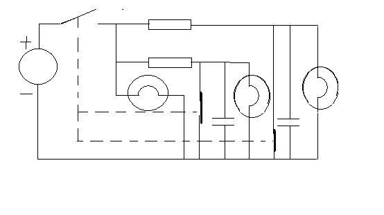

Hello all, hope everyone is having a good week so far.
Anyway I am trying to solve a problem, hopefully you guys can help me with this.
I made a quick drawing on Paint to try to explain myself, sorry for the poor art.
So basically in the circuit shown in my drawing, if you hit the switch then lights 1, 2 and 3 will receive 12 Volts DC and light up.
The effect that I want to achieve is to create a delay on lights 2 and 3. So when you close the switch, light 1 will light up 1st, then after a few milliseconds, light 2 will light up, and finally after a few more milliseconds, light 3 will light up. At this point all 3 lights are on. And once you open the switch all 3 lights will turn off at the same time.
I want to know if there is a simple way of doing this. The circuit in my drawing is an existing circuit, I would like to modify it to do what I explained above. I really don’t want to involve an Arduino or something of that caliber. Is there a simpler alternative? Maybe some type of component that I can place right before lights 2 and 3 to create that delay I need?
I was thinking capacitors maybe?? But That might not work since I need all 3 lights to turn off at the same time once the switch it re opened, and if I use capacitors this probably won't happen right?
Any help would be greatly appreciated!

You'd have to calculate your RC time constants yourself. The switch is a 3 pole 2 throw switch readily available for cheap off RS. You have to wire up the "main pole" up NO and the other 2 poles need to be NC, this will discharge the caps ready for the next time you operate the "main pole".
jonlg_uk, Thanks for the quick response and diagram!
Sorry to be a drag but I did not fully understand everything you said, I have to point out I have not studied EE. I have read a few beginner/intermediate books though.
RC time constant refers to what capacitor I would use correct? If so, yea I figured if I went this route I would have to figure out what size caps to use.
Now I did some research on the switch you talked about and it sounds like that would work. But I failed to mentioned that I cannot modify the switch(the one I drew on the diagram). The switch mechanism cannot be changed, what I can do is modify the circuit after the switch, where the lights are. So that's why I'm wondering how I can do this, is there a special relay I can use with the caps or something like that?THANK YOU

Yes you can get electronic Delay On Timer relays these are readily available from rswww. If you go down that route then there is no need for capacitors or resistors like I drew.
Here is something similar to what you need:
http://www.ics-timers.com/op4142_2.html
If you are not familiar with EE, buying after market delay will be the best way to go if they are available. RC is not a good way as the R will drop voltage and rob some of the voltage from the bulb, so your bulb two and three is going to be dimmer. It gets a lot more complicated if you want them to shut off at the same time as you are going to have to discharge the cap. Opening the power switch do not automatically discharge the cap even if you use a diode for discharging, you literally have to switch to ground to discharge the cap. Then another complication arise...the in rush current through the diode to discharge the cap is going to be high and not only you need a big diode, you need a robust switch to take the high current surge so you won't melt the contact...

Yeah I read somewhere that it takes a human about 1/10 of a second to react to a stimulus, not sure if this applies to being able to distinguish between stimulus.
You are right, I'm not sure exactly how long the delay needs to be but it is about 200 to maybe 300 milliseconds.
The more I think about this it gets more complicated though. I know its possible because I've seen it done. I'll explain what exactly I was trying to accomplish here.

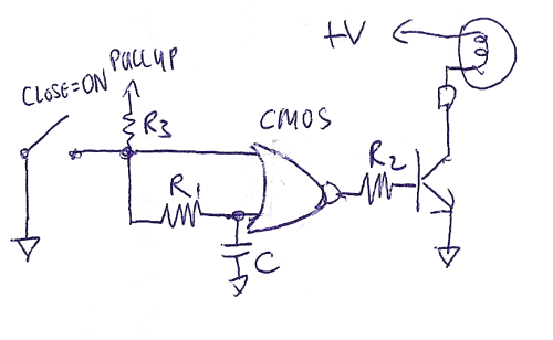

OK, I don't know how much you can follow. I don't know what is the wattage of the light. But this is a simple circuit using a CMOS NOR and an NPN transistor. This is assuming you use DC to power the lamp. I don't know the latest CMOS gate family and I am too lazy to look at data sheet. So I did not specify the part number for you.
The delay is governed by the RC, so you can have two of this with one having a long RC time constant for bulb 3.
I choose CMOS gate to get a higher switching threshold voltage for the RC part. TTL is not good.
Take a look, this is not a finished circuit, just an idea. If you think you can build it and need more help, post back.

yungman said:
OK, I don't know how much you can follow. I don't know what is the wattage of the light. But this is a simple circuit using a CMOS NAND and an NPN transistor. This is assuming you use DC to power the lamp. I don't know the latest CMOS gate family and I am too lazy to look at data sheet. So I did not specify the part number for you.

If you are more serious about going for it, give more detail about what voltage DC you are using, what is the wattage of the bulb. So we can track and offer more solid suggestion. Right now, it's just talking in the thin air. If the bulb is high wattage and need more current, a darlington NPN or even an N MOSFET is possible. Just more details.
Sorry, I wasn't thinking, It should be a NOR gate, not NAND. I edited the original post already. Sorry.

Now the design is much clearer. If you are using 12V, look into the old CMOS 4000 series logic family that was popular in the 70s.
http://www.analog.com/static/imported-files/rarely_asked_questions/4000_Series_Article.pdf
They work with Vcc up to 15V. They are perfect for you as you don't need an extra supply to power the logic. Keep R3 like 20K or lower and R1 at least 200K. I would use a N MOSFET, then you eliminate R2 all together. The 4000 family has very weak drive, MOSFET will be the best choice.
Be very careful when handling these logic. In my days, this family have no protection at the input and they are very susceptible to static damage. Always store them in static protection bags or foam. Ground yourself to the Earth ground before you even think about handling them. My experience is they never burn right on the spot, they get "injured"! They usual die in a few days. I remember every time we probe the board, certain IC will die in a few days. It was to the point when the system failed, we just change one particular chip without even trouble shoot. It was that predictable. The one that was the worst was 4049 inverter. The NOR did not seem to be as bad. We were not careful about grounding ourselves, but if you take all the precaution, they are very reliable.

Yes. Make sure you ground all the other unused inputs. Tell me the wattage of your bulbs, I might be able to choose a MOSFET for you. I have good experience ordering in DigiKey, they ship FAST! average 3 days! They should carry everything you need...I am not advertizing for Digitkey, I have not try other places, I hit the jackpot with the first one, never have any reason to try others.

Then it should be very easy, 28W means it's draw less than 3A, plenty of MOSFET can do it for you.
Yes, you need two of the circuits for two different bulbs. You change the R1 and/or C to set different delay time.

OK, my call went smoothly, so here it is:
http://www.digikey.com/product-detail/en/IRFZ14PBF/IRFZ14PBF-ND/811717
This is the first one I saw, not necessary the best one. You can buy anyone in Radio Shack or Fry's. I just look for one that is twice the voltage requirement ( anything higher than 30V) and can sink more than 6A. The gate source voltage has to be able to handle 0V to 15V.
The requirement is very easy. Don't get too big a transistor, the bigger the MOSFET, the higher the input capacitance. The output drive of the 4001 is not very strong. High input capacitance will slow down the switching time. It is not critical as you are looking at mS though.

Vk6Kro is correct, you only need one IC. Everyone has 4 gates, so you can build 4 light bulb circuits with one IC. That's the reason I told you to ground the unused inputs of the extra gates. Get the one in DIP package though.

Yes, it looks like a good circuit.
Just keep all your connecting wires VERY short and it should work OK.
