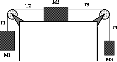

In the figure below, M2 has more mass than M1 and M1 has more mass than M3. The questions refer to the magnitudes of tensions and weights. There
is friction between the horizontal plane and M2 (mu_k not equal to 0). M2 is observed to travel at a constant speed. Assume that the pulleys are frictionless and have negligible mass. Select the appropriate symbol for each statement: T (True), F (False), G (Greater than), L (Less than), or E (Equal to). (If the first two are 'greater than,' and the last four 'less than,' then enter GGLLLL).
A) T1 is ... T2.
B) M1 g is ... T1.
C) The magnitude of the net force on M2 is T2 - T3.
D) M1 accelerates downwards.
E) T3 is ... T2.
F) T4 is ... M3 g.
F=ma
So far, I have: LExTLE, where x is unknown. I am not sure if these are right, just looking for some guidance on this problem really.

Welcome to PF!
Hi _MNice_! Welcome to PF! :smile:
_MNice_ said:
A) T1 is ... T2.
B) M1 g is ... T1.
E) T3 is ... T2.
F) T4 is ... M3 g.
F=ma
hmm … 2 out of 6 correct :redface:
almost everything in mechanics is done by applying F = ma
call the acceleration "a" (it's the same for all three masses), and apply F = ma to each of the three masses (separately)
(also to a tiny bit of string round each pulley)
show us what you get :smile:
