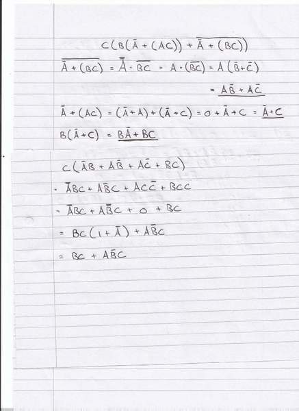

I have attached the problem and my working. It would be much appreciated if someone could check through my working and let me know if I have slipped up anywhere.
Thanks in advance
Steve

Attachment not attached.
I realized that I had made a couple of errors so I deleted the attachment. I have now reattached it above.
Also, I’ve just realized that A’+A=1… (the 0 I have put is incorrect)
So
A’+(AC) = (A’+A)+(A’+C) = 1 + (A’+C) = 1
B(1) = B
C(AB’+AC’+B) = AB’C+ACC’+BC = AB’C+BC = AB’C+BC (which somehow is the same answer as before)Cheers
Steve
4th line:
~A+(AC) = (~A+A)(~A+C) = 1(~A+C) = (~A+C) --got lucky.
last line:
BC(1+~A) != BC
ok I see,
1 + (A’+C) is actually 1(~A+C)

What is your final simplification of the expression, Steve Collins?
ac+bc

Is this your answer to my question? If so, write it as c(a+b), though that is still wrong. The easiest way to check is to draw up two truth-tables, one for the original expression, and another for your simplification. They should agree.
Please explain what rule you used to go from the LHS to the RHS here:

A'+(AC)=(A'+A)+(A'+C) Should have read A'+(AC)=(A'+A)(A'+C)
