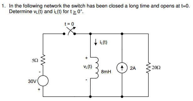

Circuits Question -- Voltage and current in an inductor circuit
See Attached

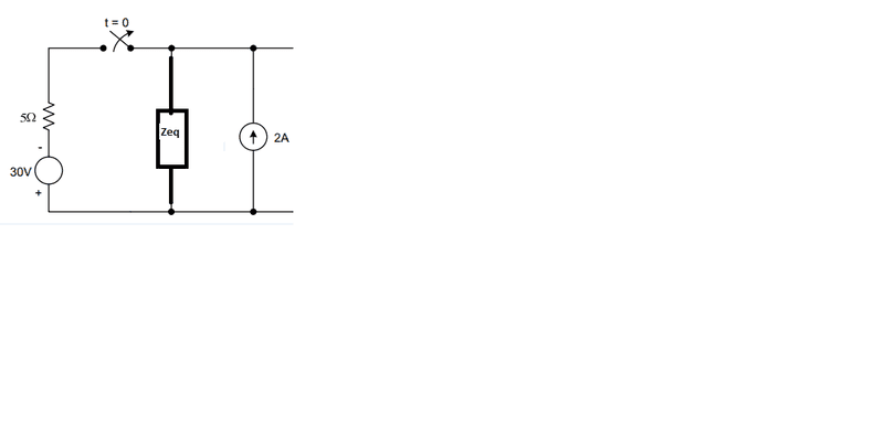

I found Zeq and there are exactly 2 Amps going into it. I'm not sure what to do from here.
[itex]Z_{eq} = \frac{<(arctan(\frac{R}{ωL}))}{ω^{2}L^{2}+R^{2}}[/itex]
I'm not sure what to do from here, thanks for any help.

Ok so because this is DC
ω = 2∏f
but f= 0
so
[itex]Z_{eq} = \frac{j}{R^{2}}[/itex]
Where do I go from here?
vL(t) = 120e-2500t
iL(t) = 2 + 6e-2500t
