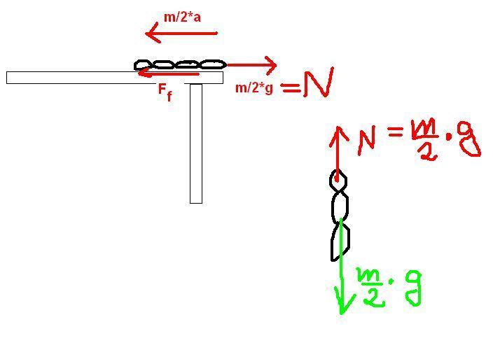

Your first equation (Fnet = ma) could be useful. What are the forces acting on a chain?
The forces acting on a chain are Fg, Fn, Ft and Ff, why? How can Fnet= ma help?
Could you draw a fbd for the half of the chain that lies on a table?
Okay I drew it. FBD of hanging object only has Fg and Ft
The one on the table has FN, Fg and Ft. ?
Exactly. Could you now tell what is Fnet?
Tension? But I don't know how to calculate it.
Check the fbd I attached. Does it help?
A little but I just calculated each of those and subtracted. It comes to zero.
Can you please tell me how you got those formulas?
Well, I "cut" the chain on half. I know that only force on the hanging chain is m/2*g. That force is also "transferred" on the part which lies on the table. After that, you make the equations.
But, without fbd you can guess that mg of the hanging chain is pulling him down and the Ff which comes from lying half of the chain is trying to hold him in place.
What does N in your equation stand for? Just normal force?
Also, If the magnitude of the external net force is 0, That makes the acceleration also 0 correct because Fnet= Ma
0= 0.3 x a
0 divided by 0.3 = 0.
That makes them both zero.

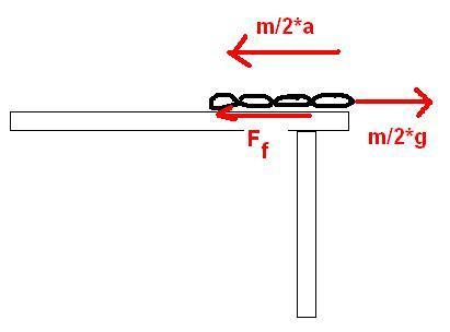

No, I explained it badly.
Please ignore attached photos.
Let's try like this: you have a half chain lying on the table. The friction force is mass of that chain (half of it which is on the table) multiplied by friction factor and gravity.
The other force that is acting on it is the force that is "pulling him down". That is the mass of half the chain that is hanging multiplied by gravity.
Those two forces make Fnet, ant they differ in direction: Fnet= 0.5*m*g-0.5*m*g*u, but i don't see gravity factor anywhere...
What the does "u" stand for in your equation?
Friction coefficient. But I don't see you have it here...
My question is why are you guys trying to incorporate friction? It says in the question the chain is accelerating, which means there is a net force. So the net force of the object when it is half over is simply m/2 * g. The object is not in equilibrium, so there is nothing that definitely says there is friction. You're trying to find acceleration, the whole chain is accelerating, not only the falling half, so the mass of the system is the entire .6. So .6a = .3(9.8) so a = (.3 * 9.8)/.6 and a = 9.8 / 2 and a = 4.9m/s^2
Also your external net force is correct at 2.94N
