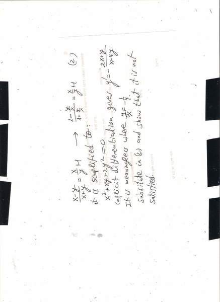

Find an equation equivalent to [itex]\displaystyle \frac{x-y}{x+y}=\frac{x}{y}+1[/itex] which shows that this equation cannot be satisfied by any combination of x & y.
Alternatively, solve this equation for x or y.
Attached
I understand this, but how would I go about doing so? I already derived it and what I got wasn't all that nice.
Also the picture is very helpful! How did you go about simplifying it down so far?
Nvm, I simplified it down lol. My brain froze for a minute there.
hedipaldi said:
Attached
So where I substitute in (2) do I have to get (2) in terms of one of the variables and then substitute that in for the variable?
Substitute -1/4 for y/x and see that (2) is not satisfied.
I just realized that right before I seen your post (I'm not having a good night lol) So last question, I promise, how did you come up with the -1/4 ?
the denominator of y' is 0 where x+4y=0,that is,y/x=-1/4
Ok, I see that. So when you plug that into the initial equation (2), it shows that both sides are not equal. Wouldn't that show that there are in fact points on that curve? I'm just totally missing this whole question in general. I really appreciate all you help for this by the way!

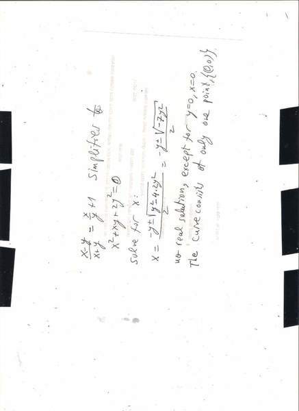

Complete the square on the x^2+xy part. You can write it as (x+y/2)^2 minus something. What's the something?
Attached
Thank you Dick, my brain is mush at this point. (Been at this for the past 4 1/2 hours)
hedipaldi said:
Attached
Thanks, this is great. You and Dick are life savers! I understand this completely now.
it suffices to indicate that the discriminant is negative for non zero y.

Actually the point (0,0) is also not on the curve since it gives 0 in the denominator,so the "curve" contains no points at all.
I was trying to get you to write x^2+xy+2y^2=(x+y/2)^2+7*y^2/4. That gives the sum of two nonnegative things equal to zero. So both must be zero. Same conclusion, really.
