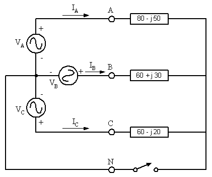

In a 3-phase circuit, the switch SA is opened, disconnecting the grounding wire. Due to the powerful generator, the voltage between phases remains the same - 400 V. The impedances are given. Find all the missing voltages/currents.
First of all, as the voltage between the phases remains the same, that means that when the grounding wire was connected, the voltages in the phases were 400/sqrt3=231 V
The problem I am having here is finding the voltages. If those were given, it would be rather easy to find the rest. I usually tend to solve these by using the vector diagram and solving the given triangles (I don't know is this is the proper way to do it, but so far it has given me right answers).
Now that we are only given the impedances and the voltage between phases, it leads me to believe that we are supposed to find the currents first, and then find the voltages by multiplying the found currents and impedances. But I am not really sure on how to find them.
I tried adding the according impedances together: Za+Zb and then Za+Zc. Then find the currents which which go from A>B and A>C (as the voltages between both of them is 400 V.) Then add the A>B and A>C vectors together to find Ia.
This seems to be incorrect though, giving me answers off by about 0.3-0.5 A.
So why didnt this way work? How to approach the problem?
And what exactly causes the voltages to change when the grounding wire is disconnected?
Thanks in advance
Redraw the circuit with the phase voltage supplies included. You should know the phase angles and potentials for these sources. The rest should be straightforward circuit analysis.

When the neutral line from the power supply common ground is severed by opening the switch, the common ground for the loads becomes a "floating" ground; it's no longer pinned to the reference point of the power supply's common ground. That allows the voltage measurements between the phase buses and this floating ground to vary depending upon the given loads.
You end up with a circuit that consists of two loops with three independent power supplies as I've drawn. These power supplies have specific voltages and phases between them WHICH DO NOT CHANGE NO MATTER WHAT, and you should be able to state what they are. Solve the given circuit for voltages and currents --- you have the voltage source values and the load impedances so all voltages and currents can be calculated.
A convenient approach might be to take the floating ground as a reference point and use nodal analysis to find the relative potential of the power supply neutral node. Then the individual voltages and currents for the branches can be found.

Yes, the phase angle is 120° between sources. The standard practice is to assign the first phase an angle of 0°, the second an angle of -120°, and the third an angle of -240°.
I think you worked out the individual source voltage previously, yielding 231V for each source (in particular, the value is ##400V/\sqrt{3}##).
If you take two of the sources using this voltage and their phase angles and take the difference, you'll find that the magnitude is 400V.

Sorry, I'm not following your description. You need to write KVL loop equations or KCL node equations to solve for the currents. Because the branch ground is floating there will be interactions between the voltages and currents in the branches, so you must write the circuit equations to sort them out.
Note also that the 400V between buses will also have associated phase angles! So you can't just assume 400V with 0 phase angle!
My suggestion is to assume a reference point at the branch grounds (the right-hand side where all the branches come together) and use nodal analysis to solve for VN, the source's neutral voltage with respect to the branch grounds. Then you'll easily be able to write expressions for the voltages and individual currents.

In a 3-phase system, if all three loads are exactly balanced (ie all equal) then no current flows through the N wire. This means you can disconnect it without any changes in voltages or currents occurring.
This problem is showing that if the loads are not balanced, current does flow in the N wire and disconnecting it will cause changes to the voltages and currents in the circuit.

The only fixed phases angles will be those of the individual power supplies feeding the branches. Because the neutral line has been severed, the phases and voltages between the branches are going to sort themselves out by mutual interactions of the currents and potentials. That's why you need to apply Kirchhoff's laws and analyze the circuit.
And I didnt actually assume the phase angle between the 400 V's to be 0. I took it as 60 degrees (solving with the triangles), but it gave me a worng outcome.
Im pretty sure I am missing some important phase angle here. It would just be easier if one of you could point it out, or name the actual phase angles between those voltages so I could compare them with my results.
As stated above, removing the neutral tie point from the common junction of the voltage generators is going to change the current paths and phases angles in the branches.
Write the circuit equations and solve for the currents and potentials.
I mentioned one approach (solving for VN using nodal analysis) which I think is practical, but you could also write and solve loop equations.
