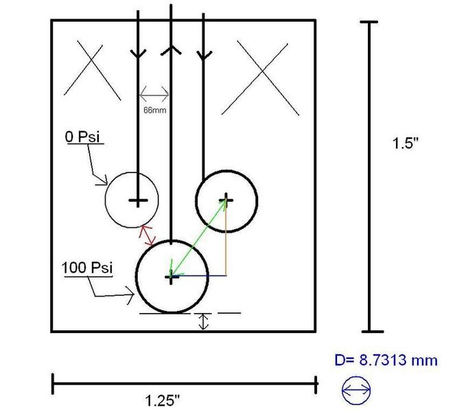

Hey everybody! Need some help with a design I'm coming up with for myself- it's an air valve block.
What I'm having trouble with is figuring out how close I can make the holes to each other?
I don't have any computing software that does this sort of thing or calcuations so I whiped up something in MS paint to show you:
The diameter in mm is there, max psi will be 100 (maybe 110 to be safe..).
The center hole is in the exact center of the block with one passage. The other two passages are 66mm on each side.
The passages for the air are fixed, but the holes can be moved off center (I think?) as they are just exhausting to atmosphere. Shouldn't affect it right?
Material is 6061-T6 Aluminum.. I would find a value for you in regards to pressure rating but I don't know which one I am looking for?
Summary:
All holes same diameter. Able to offcenter the two from their passages.
Looking to keep holes as far down as possible to allow for more stuff in the top of the block.
-How far off bottom should the hole be?
-How close can the other two holes be to the pressurized one, and it's pressurized air passage.
(Give green line value if you can, as I want to trace a line with a compass off the center mark of the bottom one)
-Assuming 110psi including safety margin.
Thx, and any questions feel free to post!
Considering the yield stress of 6061-T6 is 40,000 psi, I don't think there is anything to worry about for 100 psi pressure, unless you want to make the gap between the holes a fraction of a millimeter for some reason.
But the needed material is a function of the pressure that it holds back correct?
For example it will be more for 20,000psi, thicker will be needed for more pressure//
I just need the value for thickness at 110psi but I'm not sure how to do it with the circular hole..
**Whoops that should say 6.6mm not 66! Only 31.75mm to work with.

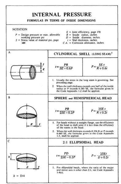

If you just consider a circular pipe with 100 psi pressure, the minimum wall thickness to contain the pressure would be (100/40,000) of the radius, which is much smaller than any real design would be.

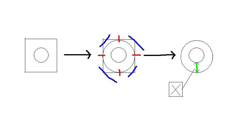

That's a completely different ballgame, because the stress around just one hole in a large block is getting close to the elastic limit of the material. You would need to make a finite element model (including the material nonlinearity) to check that out.
So to get a rough idea I will use the fact that the corners of the block are not my limiting point- the sides will fail before anything else does..
http://miutj.files.wordpress.com/2009/02/manual_recipientes_sometidos_presion.pdf
Using that web info for pressure cylinders I plug some values in and I came up with:
t(inches) = ((110Psi)*(0.34375 inch))/((40,000*1)-(0.6*110))=
0.0009468748 inch * (25.4mm/1inch) = 0.0240503 mm
So assuming the material is made to spec (which it's not really..it's unknown quality but seems ok) anything over 1 mm should be aces?
It's just so hard to believe one little mm is enough.. this stuff cuts like butter! :O
