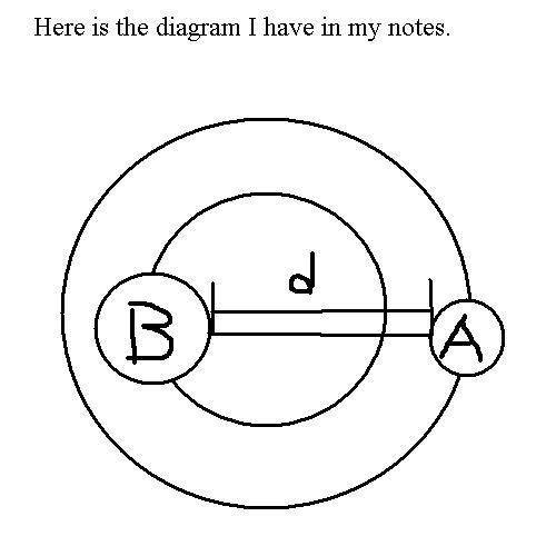

The binary star system Krell consists of two stars, Krell A and Krell B, orbiting each other, with no other ojects nearby. Assume Krell A, the smaller star of mass mA, moves in a circle of radius rA at speed vA. Krell B, the larger star of mass mB = 2.51mA), moves in a circle of radius rB at speed vB. The two stars are separated by a distance d.
Find the ratio of the periods of orbit TA/TB
I would assume these formulas:
→T²/r³
→T²/r³ = 4π²/(G(M + m))
I believe the approach is...
T_A²/R_A³ = T_B²/R_B³
T_A²/T_B² = R_A³/R_B³
(T_A/T_B) = √((R_A/R_B)³)
From the previous part of the problem, I've found that R_A/R_B = 2.51. Then, I substitute that for the above expression and got the answer incorrect.
T_A/T_B = √(2.51³) ≈ 3.98
But the answer is incorrect.

Maybe approach the problem from a different perspective... It's an isolated system of two objects that don't interact with anything external. What characteristics can you ascribe to the center of mass of such a system?

The masses are distance d apart, orbiting the common center of the mass. This is by the modified form of Kepler's third law.
Where does the center of mass lie with respect to the orbiting bodies (in terms of the geometry of the system)? Does it move?

The center of mass lies along the path where the larger mass will rotate. I believe it moves.
Umm, no. If you have two masses and you want to find the center of mass of the pair, do you expect to find it to the left of them both? Above them both? Or perhaps along the line segment joining the two?
If no external forces are acting on the system, what would cause the center of mass to move? This is introductory stuff regarding the motion of the center of mass of an isolated system (relies on conservation of momentum).

Then, the center of mass lies along the line segment joining the two? I believe that the center lies somewhere closer to the larger mass.
Nvm. The answer is 1. The velocity and the radius of the orbits are inversely proportional to each other. If the distance between the masses changes, then the periods for both masses are not all the same. If both masses are distance d apart, orbiting the common center of mass at the opposite directions, then the center of mass is "consistent" and so the change of momentum is 0.
Correct conclusion, but part of your reasoning is flawed. Even if the distance between the bodies changes, so that the orbits are elliptical rather than circular, the periods must still be the same.
The center of mass cannot move (assuming the coordinate system chosen has its origin at the center of mass) because there are no external forces operating. Further, the center of mass must always lie along the line joining the two mutually orbiting bodies. That means that when one body completes a full orbit and returns to its starting position, the other body must also return to its diametrically opposed position at the same instant.

It is just a matter of understanding what the orbital period is - if you are on one celestial body and observing other, orbital period is a time required for the other body to appear in exactly the same place on the sky (in the reference frame of distant stars, which makes local motion of the system irrelevant). That means after a period passes from the body which you are observing you are also seen in exactly the same place (which happens to be in exactly the opposite direction, hence zodiac sings that are exactly 6 months apart).
