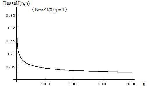

Sorry, I cannot understand your wording. Do you mean J(n=eta) = J(n,n) ?
If yes, where is no overshoot. The function BesselJ(n,n) is fairly regular.
Also, on your plot, what is drawn as a function of what ?

As I already said in my previous post, the function BesselJ(n,n) is without any overshot. It is a regular function continusely decreassing, without oscillation. See the graph in my previous post. This is confirmed by WolframAlpha :
http://www.wolframalpha.com/input/?i=plot+BesselJ(n,n)+from+n=1000+to+n=5000
