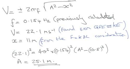

There is a further question that although I can apply the formulas I still struggle to see why this works.
Use your answers from parts (a) and (b)(i) to show that the amplitude A, which is the
distance from Q to R, is about 25 m.
Why can we use these values? Is it simply that we can say that on return to the point P after the first oscillation she will arrive there with the same velocity as she had when she was originally fell to P through the 25m distance. The speed at P being calculated from KE=GPE (v=sqrt(2gh). Then from conservation of energy if we ignore any dissipation of the energy the girl will bounce back up and be at the same speed at P again when she returns to this point moving vertically upwards?
