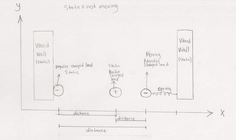

I want to know how to negatively charge a piece of lead to experiment with it and other pieces of lead. What I want is basically saturate it with electrons. I know that rubbing objects with a cloth will add static electricity to them, but a cloth won't give them enough charge to possible see the repulsion of them with my eyes. I need to really really saturate them with one charge to see the effects. Anyone here knows how can I accomplish such a task?
I chose tiny pieces of lead because it is not attracted by magnets so that way I eliminate any interference of other things around generating magnetic fields (for that matter even the Earth's magnetic field) and see the full effects of the phenomena.
This is where things get complicated. If you have two charged objects and you put a metal plate between them, the electric field between the two objects will move charges in the metal plate, so that metal plate produces its own electric field which will add up with the field produced by the original charged objects... It gets complicated.
I like the general challenge though. Superposition principle is rather central in physics. It comes up in some far more interesting contexts. And it certainly does work. But showing a simple and clear demonstration of that, that would be neat. I'll try to think of something.
In the mean time, why doesn't it bother you that the gravitational pull of the planet isn't shielded by anything placed between you and ground?
Unlike what the superposition principle says, I believe objects in between do have an effect.
That is not what the superposition principle says. Superposition simply means the force or the electric field at a point is the sum of each individual charge's contribution to the force or electric field.
To show this experimentally simply measure the electric force between two objects, A and B, then measure the force between another, A and C. Add these forces together and that is the force you would get if A, B and C were all there at once.
Oh... that which you just said hit me in the head. I never thought of it that way but yeah, there's some truth to it that I cannot deny. It's practically the same problem, but with gravity. When I was a kid I was once told gravity keeps us attached to the ground and I simply believed it without questioning it. I never even tried to imagine how it worked. I suppose that because I am grown up now and electricity is something new to me, there is something that bothers me about it and that's why I am questioning these things.
I attached an image of what I wanted to do, but what you just said about electric fields is indeed a situation that has to be taken into account. I was thinking about putting at one point a negative charged piece of lead against a wall, in the middle a glued piece of positively charged lead and in the other extreme another negatively charged piece of lead but this one would be connected to a spring. Restrain the movement of the spring piece of lead to move exactly in the X axis only and align all the pieces in the same axis. Then measure the distance between them and see how much the spring compresses because of the other negative piece of lead at the other side. Then calculate the force exerted over the piece of lead in the spring according to the distance that the spring moved.

My bad. I expressed that wrong. Here attached is an image of the problem that I feel uneasy about. Look what I marked in red to see what the book says about superposition. However, I believe that Q2 does block the effect of Q1 acting on Q3. The book says it doesn't, that Q2 in no way blocks the effect of Q1 over Q3. Don't you think there is something weird about it? Like it is in the middle, but like it is not there at all? Like interactions between two of them is private and not public.
I know magnetic fields are a different subject and its ruled by different equations, but let me illustrate what I believe that must happen too with electric charges by comparing them. Magnetic fields, like electric charges get weaker as distance increases. However, if you put mu-metal between two magnetic fields, regardless of the distance, the field will be weaker and hence their attraction or repulsion will be weaker too because the mu-metal attenuates the field. I believe the same must happen with electric fields, an electric charge in the middle must attenuate the effects of one electric charge at one side over another at the other side and not ignore it. The problem is that the equation doesn't say that and I want to make an experiment to see with my own eyes if superposition is true.

I like the compass one, but I didn't quite got it. Like how I do it, do I bring the magnets closer to each other with opposite poles facing each other and the compass needle in the middle of them?

ya just have the magnets as close together as you can. Just stack the magnets together like 2 bricks. on each end a north pole should be next to a south pole like
[N S]
[S N]
