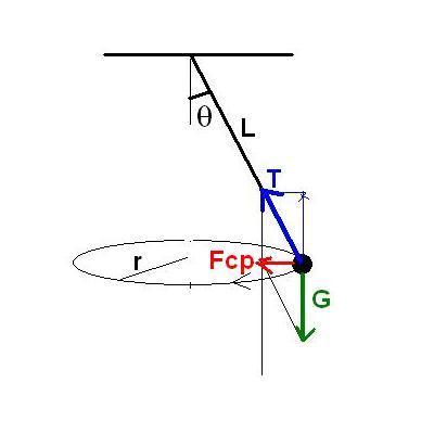

Consider a ball tethered to a post by a string. The faster it spins, the higher it gets until the bAll is the same height as the place that the string is attached to the post. What force accounts for this?

The answer is implied in the question: it isn't horizontal. No matter how fast it goes, it will always have some downward angle, even if it is too small to see.

The ball is not pulled horizontally: it is pulled by the string at an angle with respect to the vertical. Two forces act on the ball: the tension of the string (T) and gravity (G). The ball moves along a horizontal circle (of radius r) if the resultant of these forces is horizontal. That horizontal resultant is the centripetal force. T
The tension in the string has horizontal and vertical components. The horizontal component provides the centripetal force:
Tsinθ=Fcp=mrω2.
The vertical component acts against gravity and if it is greater than G the ball will rise. The ball can move along a horizontal circle with angular speed ω if the vertical component of the tension cancels gravity:
Tcosθ=G
The radius of the circle is r=Lsinθ.
Tsinθ=mLsinθ ω2->
T=mLω2
and
cosθ=G/T=G/(mLω2).
The faster the ball spins the greater ω; the greater the tension in the string. Also, increasing ω involves decreasing cos(θ), that is, increasing the angle the string makes with the vertical. If θ is greater the ball spins higher.
