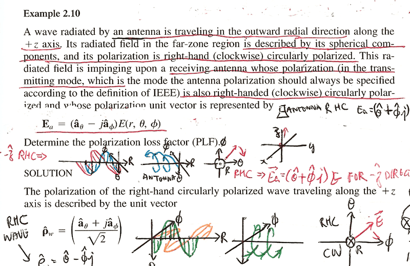

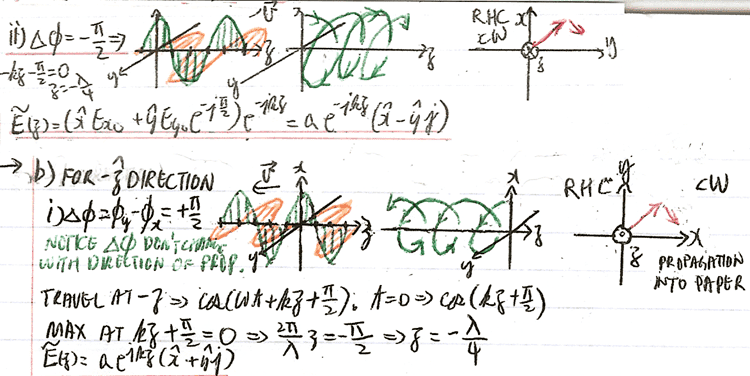

Yeh, I got the LHC and RHC wrong. Now I want to confirm that I got this all correct.
158503[/ATTACH]"]
1) I show the RHC wave travel in +z direction on the top. The Ex is shown in green and Ey is shown in orange. This is the receiving antenna and [itex]\Delta\phi=-\frac{\pi}{2}[/itex].
2) I show the transmitting antenna in the bottom that radiates a wave in -z direction.
Please confirm that I am correct. I have not seen any book draw out the orthogonal components of the waves, I just want to confirm I got this right.
Thanks

Balanis's "Advanced Engineering Electromagnetics" does a good job of explicitly explaining the concept in his fourth chapter with the figures as you have desired. The simple way of looking at this is by constructing a 2D plot where the cross-product of the axes gives you the direction of the wave propagation (hence the specifications I gave for the axes in my previous post). Then you can simply plot out the progression of the polarization as a function of increasing t using the real part of the time harmonic expression. For example, [itex]Re \left\{ \left( \hat{x} - j\hat{y} \right) e^{j\omega t} \right\}[/itex] at t= 0 is [itex]\hat{x}[/itex] and at say t = 0.01 and a unity wavelength is [itex]0.998\hat{x} + 0.0628\hat{y}[/itex]. From those two points we can easily discern the handedness of the propagation.
A more rigorous and general way of finding the polarization is by use of the Poincaré Sphere. Using the Poincaré Sphere, we find that [itex]\gamma = \tan^{-1} \frac{1}{1} = 45^{\circ}[/itex] and [itex]\delta = -90^{\circ} - 0^{\circ} = -90^{\circ}[/itex]. This gives the point on the sphere to be [itex]\epsilon = -45^{\circ}[/itex] and [itex]\tau = 22.5^{\circ}[/itex]. From the [itex]\epsilon[/itex], we deduce that we have an RHCP since [itex]2\epsilon[/itex] means that the point lies at the southern pole of the sphere.
I'll say that your figures seem to be correct though I do not think that mapping out the explicit orthogonal components of the electric field has much utility when compared with the superposition of the two since the latter clearly demonstrates the circular polarization.

There is more confusion! I am using the 2nd edition only because I have downloaded the solution manual on line. But the convention in the example inside the book and the solution of the problems are using a different convention. Attached is a scan of Example 2.10 in p71 of the Antenna Theory 2nd edition.
158525[/ATTACH]"]
Just ignore all my writing on the book, just read the text only. The standard convention of a RHC antenna transmitting in +z direction should be [itex]\hat{\rho}_w=\frac{\hat{\theta}-\hat{\phi}j}{\sqrt{2}}[/itex] as we both agreed. And the receiving antenna has to be along the z axis with transmitting wave in -ve z direction. Therefore [itex]\hat{\rho}_w=\frac{\hat{\theta}+\hat{\phi}j}{\sqrt{2}}[/itex].
But as you see, the answer in the book is exactly opposite. The answers in the solution manual are exactly opposite from what our understanding. I am confused. The solution manual is written by someone else, but I take it that the book is not wrong!
I draw the wave just for my own understanding in the physical sense. Also the book did say the sense of rotation is from the wave with leading phase to the lagging one. By drawing the two orthogonal components out, I can see the rotation.

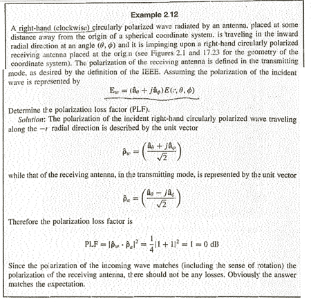

I bring this one up again to show all the inconsistency from Balanis.
yungman said:
Thanks for your detail reply. I just ordered the Advanced EEM by Balanis from Amazon. I am using the Antenna theory by Balanis also, so we are talking about the same convention. I have both 2nd and the 3rd edition.
159516[/ATTACH]"]
I have a hard time finding the relation between the Poincare Sphere to ellipse translation and the derivation. If you have any suggestion on materials relate to this, please let me know. I have joined two antenna forums thinking they should know these kind of things, but apparently engineers don't really care about this, all they care is RHC match to RHC and everything is fine!
Really appreciate your help.

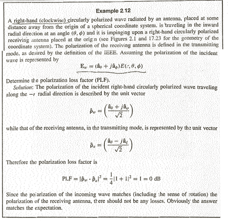

I bring this thread up again as nobody responded about the inconsistency. I since work from another angle and I still find the example in this post is WRONG.
First look at the rotation of the vector ##\hat {\theta}+\hat{\phi}j##
[tex]\vec E(0,t)\;=\;Re[\hat {\theta}E_{\theta 0}e^{j\omega t}+\hat{\phi}E_{\phi 0}e^{j\omega t}e^{j\frac{\pi}{2}}]\;=\;\;Re[\hat {\theta}E_{\theta 0}e^{j\omega t}+\hat{\phi}jE_{\phi 0}e^{j\omega t}]\;=\;\hat {\theta}E_{\theta 0}\cos\omega t+\hat {\phi}E_{\phi 0}\cos(\omega t +\frac{\pi}{2})[/tex]
Let##\Psi## be the angle from ##\theta## axis to ##\vec E(0,t)##
[tex]\Rightarrow \;\tan\Psi\;=\;\frac {\cos(\omega t+\frac{\pi}{2})}{\cos \omega t}\;=\;\frac {\cos \omega t \cos(\frac{\pi}{2})-\sin \omega t\sin(\frac{\pi}{2})}{\cos \omega t}\;=\;-\tan\omega t[/tex]
[tex]\Rightarrow\;\Psi\;=\;-\omega t[/tex]
Therefore ##\Psi## decreases as time t increases.
With this, if the plane wave is traveling in +z direction ( in spherical coordinates, in +R direction) AND draw the diagram where the propagation is INTO the paper, this is LHC ( left hand rotation). Therefore, when the book said the RHC transmitting antenna at origin radiating wave at +z direction ( +R), the unit vector HAS to be
[tex]\hat{\rho}_w\;=\;\frac{\hat{\theta}-\hat{\phi}j}{\sqrt{2}}[/tex]
But the book claimed:
[tex]\hat{\rho}_w\;=\;\frac{\hat{\theta}+\hat{\phi}j}{\sqrt{2}}[/tex]
The book is wrong!
There is no if and buts about this, there is no convention confusion. The example 2.12 in post #8 copied from the latest edition is correct. Anyone can comment on this?
