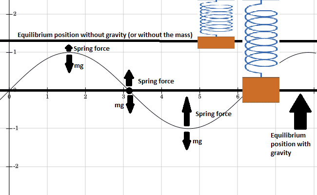

So I did this lab: http://www.physics.ryerson.ca/sites/default/files/u11/exp/exppcs125/SHM.pdf
Essentially, we have a mass that was attached to a vertical spring with as little friction as possible. We let the mass reach equilibrium and then we applied a force on the mass. The mass oscillated with the same amplitude above and below the equilibrium position. We recorded the position of the mass and it looked like a perfect sine wave. My question is: what happens if we removed gravity? Also, we model simple harmonic motion and waves using sinusoidal functions. Can we model waves without these functions?

I'm still confused to why gravity doesn't affect dynamic motion. I've uploaded a diagram.
Your diagram is inaccurate. The net force at equal distances from equilibrium will be equal (in magnitude). At the equilibrium position (where the sine function equals zero) the net force will equal zero.
Realize that spring force depends on the displacement from the spring's unstretched position, not the new equilibrium position once the weight is added.
Is this diagram better? I think I get it now. The spring force compensates for the constant weight at ALL positions.
Thanks for the clear-up.
Much better. I think you've got it. Good job.

To your second question. Let [itex]x'[/itex] the coordinate of the point mass defined such that for [itex]x'=0[/itex] the spring is unstretched. Then the total force acting on the mass is the sum of the gravitational force and the force from the spring:
[tex]F=m g-k x'.[/tex]
The point, were [itex]F=0[/itex], i.e., where the force of the spring is exactly compensating the gravitational force, is given by
[tex]m g-k x_0=0 \; \Rightarrow x_0=\frac{m g}{k}.[/tex]
Thus you can write for the force
[tex]F=k(x_0-x').[/tex]
Now setting [itex]x=x'-x_0[/itex] you find the equation of motion
[tex]m \ddot{x}'=m\ddot{x}=F=k(x_0-x')=-k x,[/tex]
which is the equation of motion for a harmonic oscillator. So, as the other posters have already explained, the reason that the gravitational force drops out is due to the counting of the [itex]x[/itex] coordinate from the equilibrium point [itex]x_0[/itex].
