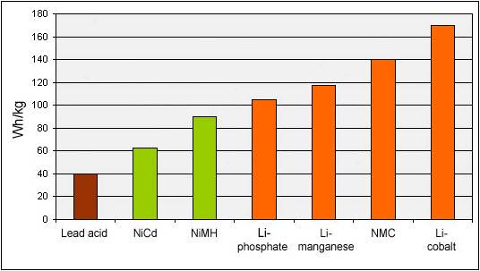

Green Car Report states lithium ion batteries are a family of products having very different performance characteristics resulting from incorporating specific alloying metals into the battery chemistry. Lithium plus manganese or/and nickel (or other metals) typically carry less energy per volume than lithium plus cobalt, but are widely viewed as less susceptible to overheating. The battery chemistry utilized by the Dreamliner was Lithium Cobalt Dioxide (LiCoO2); similar to that used in laptop computers and cell phones. American Manganese Inc.'s ("AMY") product would be Lithium Manganese Dioxide (LiMn2O4), or spinel, similar to rechargeable batteries used in the Chevy Volt. Both of these battery chemistries come under the generic heading "lithium Ion Batteries".
and from Battery University:
credit for the graph: http://batteryuniversity.com/learn/article/types_of_lithium_ion
Battery University's page is worth a look. It rates cobalt variety less safe.
