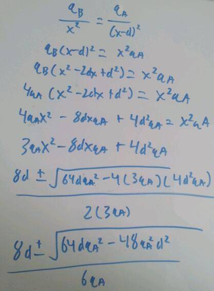

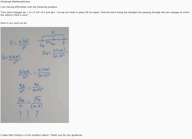

Greetings fellow physics adorers/ mathematicians,
I was wondering if someone could help me with my posted problem. All the necessary details from the template are included in the screenshot on the right.
From the second attachment (the one on the right) it looks as though you need only cross multiply and solve for x to finish.
I don't know how to do so mathematically...
Your starting formula is wrong.
Draw a picture of the two charges along a line, then equate Coulomb attraction of a unit (positive) test charge to qB to repulsion of that test charge from qA.
Hint: the zero-field point might be between qA and qB, or it might not ...
Coulomb's law is not used. My professor said to only use the E=k[q]/rsquared formula...
I know that the order of the point charges goes as followed
qb -------------------qa--------------------P
Never mind, you called x the distance from p to qB and d the distance between qA and qB, so what you wrote is fine.
Really? :confused:
If ##\frac{a}{b} = \frac{c}{d}## then ##a \cdot d = b \cdot c##
You've never seen this?
