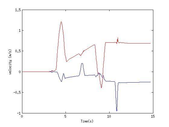

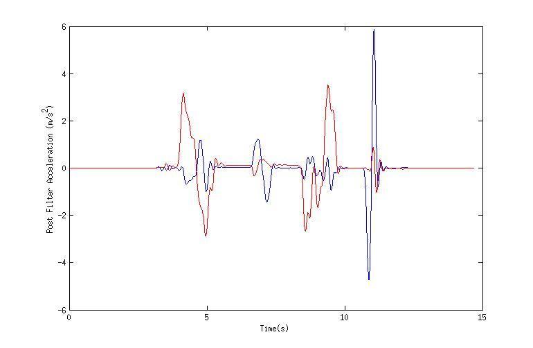

Hi,
I'm having trouble with the application of filtering to real acceleration data. I have looked at a lot of recommendations, filtering through fft, butterworth high and low pass filters, and I'm not finding something that's working for my data and I'm looking for recommendations.
I think my problem is that I am looking at very slow accelerations, so the "drift" in the accelerometer is eliminated-but so is the trend in the data itself. I will be looking at the cases of relatively slow acceleration and velocity, and slow acceleration with pauses in between sequences. A low pass filter does okay-but does not provide an accurate map of displacement in the end. Using an fft seems to also eliminate the slower trend in the data.
I have also added in elimination of values less than the abolsute mean found for a static case. This seems to help a little bit, but I may be losing some data.

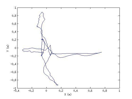

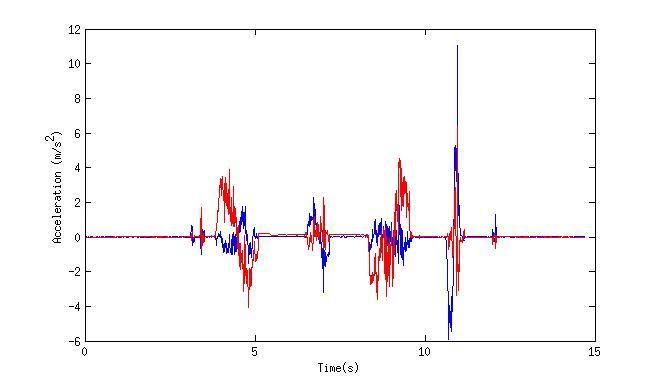

I have attached a couple of examples of what the problem is. I made a rectangle with the accelerometer pretty much and these are the results with no filters and a low pass filter.
First 2 are no filter. 2nd 1 is the LP filtered accel. (I can send velocity if interested-looks the same pretty much)
Are there any other filters I should be trying? Different methods of integration? (I am currently using a trapazoidal integrator). I'm pretty much looking for recommendations processing this type of data.
Thanks! (I also hope this is the correct thread for this).

Integrating the accelerations twice to get displacements is equivalent to a high pass filter, without doing anything to the raw data. It multipliies a component with frequuency ##\omega## by ##-1/\omega^2##.
Filtering the data in the time domain can be problematic if the filter introduces phase shifts in the different frequency components of the measured data. You can design finite impulse response (FIR) digital filters that don't introduce phase shifts, but unless there is a specific noise problem (e.g. vibration or electrical noise at a particular frequency that you want to remove) you probably don't need to do it at all.
A common problem with this sort of measurement is low frequency "drift" because the accelerometer readings are not exactly correct for zero acceleration. One way to fix that is do it empirically. If you know the start and end positions independent of the accelerometer data, add a constant acceleration that makes the end point of the graph correct, i.e. use the formulas ##v = at##, ##x = at^2/2## to estimate the "zero error acceleration" ##a##.
Trapeziod integration is probably as good as anything. It uses all the data without "inventing" anything extra, or throwing any information away.
Another practical tip is use the highest data sampling rate than you can, to capture rapid changes of acceleration as accurately as possible. Unfortunately there is usually a trade off between capturing the peak acceleration values without clipping, and getting accurate data when the acceleration is low.
If you can do your experiment so the start and end positions are the same, you can enforce that by taking an FFT of all the data, and setting just the "zero frequency" Fourier coefficient to 0. You can then integrate the data in the frequency domain by dividing the fourer coefficients by ##i\omega## or ##-\omega^2## before doing the inverse FFT, rather than doing the integration in the time domain with the trapezoidal rule.

I had a question also about finding a characteristic acceleration that can be used to cancel out the offset. I understand I want my acceleration integral and velocity integral to be zero in the end to achieve start/stop in the same place. But how can this be applied to an array of data where the equation is unknown and, in all likelihood, to get accurate results, a changing acceleration is needed to not only allow the displacement to end at 0, but to also allow the inbetween values to be accurate?
You can't get everything accurate. The best you can do is "spread out" the errors evenly do at least the final position is correct.
If you start and end with the same displacement (if doesn't matter if you measure it as 0, or something else) that means the average velocity in the experiment was zero. Similarly if you start and end with the same velocity, the average acceleration is zero.
So you can calculate the average acceleration that you measured, and subtract that from every acceleration measurement.
Then do the integration to find the velocities, as you did before.
Then calculate the average velocity, and subtract that from your calculated values.
Then do the integration to find the displacements.
Actually these two methods are really the same, because the Fourier coefficient for the zero frequency is just the average of the data points.

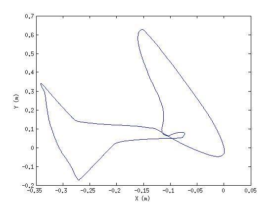

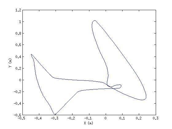

getting it to work in real life-looks like I have a bit more work to do. Neither of the 2 methods quite makes the true rectangle out of the data yet (as shown below, first averaging, then FFT) but the values are in the right range, which is good.
Code:
function disp_time_data = acc2disp(acc_time_data,dt)
N = length(acc_time_data);
acc_freq_data = fft(acc_time_data);
disp_freq_data = zeros(size(acc_freq_data));
disp_freq_data(1) = 0;
for i = 2 : N
      disp_freq_data(i) = acc_freq_data(i)/( sqrt(-1)*(2*pi*((i-1)/(2*N*dt))) );
end
disp_time_data = ifft(disp_freq_data);
return
Although, I actually had to square the bottom term (ωi) to get the graphs to be the same shape (picture 3 is the fft with the bottom term squared), which I was a little curious about, as well as why the FFT graph was offset compared to the averaging techniques. I'm hoping that I don't see a rectangle yet because on this one test, I did not end up in exactly the same place I started?

If the accelerations for one Fourier component are ##Ae^{i\omega t}## (where ##A## is the Fourier coefficient), integrating once to get the velocities gives ##Ae^{i\omega t}/(i\omega)## and integrating again to get the displacements gives ##-Ae^{i\omega t}/\omega^2##
If you integrate the FFT data, the origin will be at the mean of all the data points in X and Y. The zero Fourier coefficient represents the mean value of the data points, and you set it to 0. (Try setting it to some other value and see what difference it makes).
On the other hand, when you do the integration in the time domain, you are arbitrarily setting the first data point to be at (0,0). Again, you could use a different value if you want.
Just a thought on doing the experiment: remember the accelerometers measure accelerations in the direction they are pointing, not in the global X and Y directions. Maybe you are accidentally rotating the object as you move it around the path.

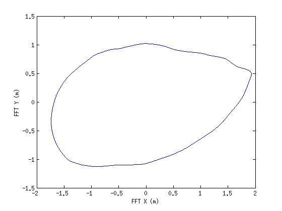

Cool! Thats kind of interesting to see.
I had been thinking about local reference frame actually in trying to solve my real problem, but I actually don't have a fixed global reference frame that I "know" about, at least not yet, that's a part of what this is about.
I suppose I could set, for this purpose, the first position as the "fixed" frame for subsequent measurements. But even then, especially as I have no idea what the path is, I wouldn't have a method of determining the transformation matrix to get from one frame to the next. (okay, I will know its an arc of undetermined radius-maybe there's an optimization or something I could do with that... although initial position of the accelerometer frame relative to the frame at the base of the arc is unknown in both rotation and translation)
I just did a decently precise circle with the accelerometer (where the accelerometer is fixed to the edge of a rotating disc), where the frame is changing all the time, to see what the result would be. I wonder if that local frame integration, without a static frame, is what causes the units and the shape to be so off in a position graph.

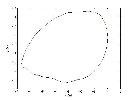

Was that a circle at constant RPM? Was it rotating in a horizontal plane or a vertical plane (where gravity would affect what you measure?)
If you fix the accelerometers to a rotating dosk at constant speed in the horizontal plane, you should measure a constant acceleration towards the center (= ##r\omega^2##). If not, I think you need to figure out exactly what you ARE measuring here.
horizontal plane with variable acceleration and variable velocity (I actually stopped and restarted the motion about 200 degrees around or there about before completing the circle).
I had wanted to do a case with uncertian accelerations, but a constant accel case might be easier to calculate for functionality.
