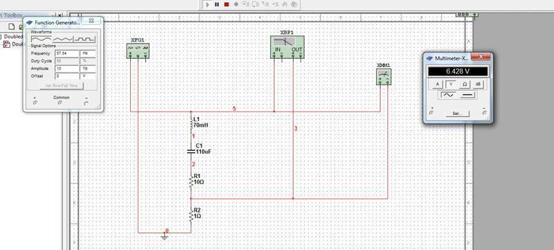

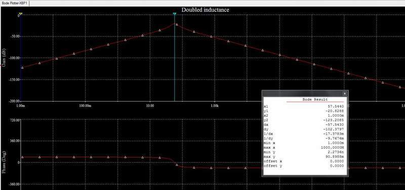

Hi,
I'm investigating what happens to bandwidth at resonance of a series RLC circuit when each component is doubled.
i have simulated the circuits and created a bode plot. You can see from the photos that at resonance the gain peaks at -20.82 dB. I would like to know how to calculate this value.
i have an input voltage of 10Vp and the voltage at resonance across the resistor is 6.428V. i understand that the voltage across both resistors is 7.07V because the multimeter is measuring RMS but how do i calculate the db level.

Thanks for the reply but that still doesn't tell me how to calculate the -22 dB.
You have a voltage divider with impedances:
Z1 = R1 + j*omega*L + 1/(j*omega*C) = R1 + j*(omega*L - 1/(omega*C) )
Z2 = R2
Your measured voltage, call it Vout, is then given by:
Vout = Z2/(Z1 + Z2) = R2/(R1 + R2 + j*(omega*L - 1/(omega*C) ) )
with magnitude:
|Vout| = R2/sqrt( (R1 + R2)^2 + (omega*L - 1/(omega*C) )^2 )
Find peak value by finding roots of the derivative of |Vout| with respect to omega and substitute into Vout, you probably know the drill.
My solution gives:
Peak value = R2/sqrt( (R1+R2)^2 + (L/sqrt(L*C) - sqrt(L*C)/C)^2 ) = 0.0909 V = -20.8279 dBV
for R1 = 10 ohm, R2 = 1 ohm, L = 70 mH, C = 110 uF.
Thanks,
Once you're broke down the equations its made it easier to see what is going on.
Thanks for the help :)
