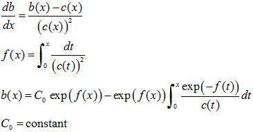

I have the following differential equation
\begin{equation}
\frac{\partial b}{\partial x}=\frac{b-c}{c^{2}}\end{equation}
where [itex]b[/itex] and [itex]c[/itex] are both functions of [itex]x[/itex]. However, although
I have a closed form relation between [itex]c[/itex] and [itex]x[/itex], I do not have
such a closed form relation between [itex]b[/itex] and [itex]x[/itex]. Is there any analytic
or numeric way to solve this problem. I want a solution linking [itex]b[/itex],
Well, when c(x) is a known (and integrable) function, then the ode for b(x) is a linear first order ODE and you can solve it by finding the integrating factor.

To solve numerically, the simplest method you can use is Euler's method.
Euler's method uses that:
$$db=\frac{b-c}{c^{2}}dx$$
From a given ##x_0## and ##b_0##, and with a stepsize ##h##, the algorithm is:
$$\left[ \begin{align}x_{n+1} &= x_n + h \\
b_{n+1} &= b_n + h \frac{b_n-c(x_n)}{c(x_n)^{2}} \end{align} \right.$$
A more advanced and accurate method is Runge-Kutta, which is described here.
The formal solution is in attachment :
