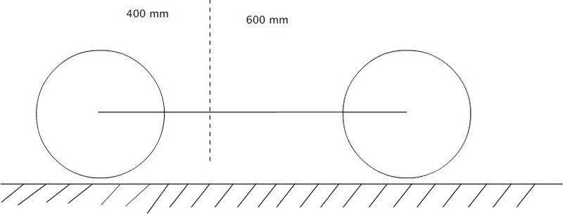

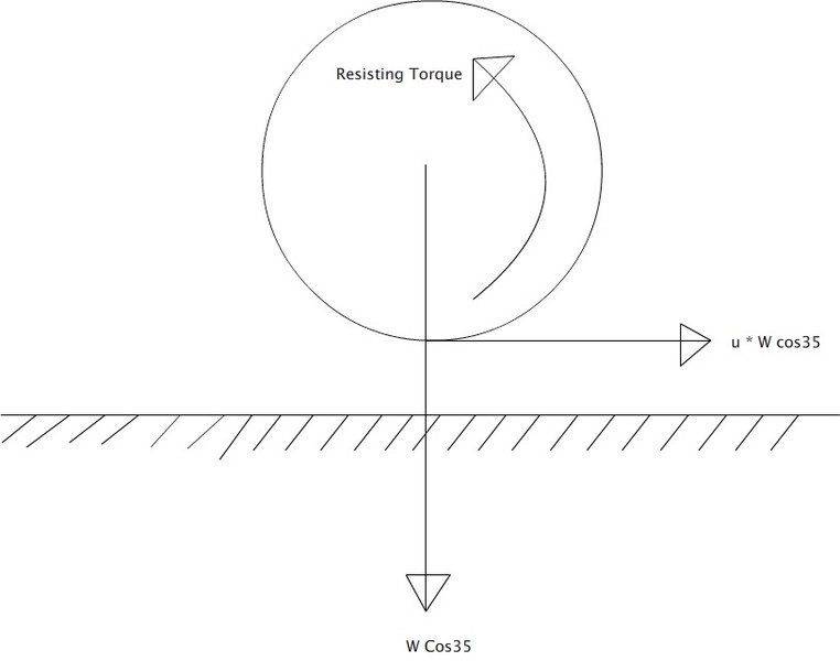

Hi everyone,
I just completed my bachelor's in mechanical engineering and have taken up a small project which involves a pedal assisted bicycle operating on both torque and cadence values.
Having completed the design and relevant estimations, I have now gotten stuck at a problem which seems to threaten my very understanding of the concept of torque. I am trying to calculate the torque required of the electric motor used by the bicycle and have taken the following design approach:
To determine the maximum possible torque required of the motor, it is assumed that the bicycle is moving up a plane inclined at 35 degrees to the horizontal. As the force which is the weight component acting parallel to the inclined plane ([itex]W*Sin(alpha)[/itex] where [itex]alpha[/itex] is the angle of inclination) acts along the centre of gravity and rear axle of the bicycle, it is assumed to have no torque in resisting the motion of the bicycle. However, the frictional forces resisting the motion of the rear wheel (which being the driving wheel, is being studied) apply a resisting torque by attempting to rotate the wheel in the counter-clockwise direction. The maximum torque required is therefore that torque required to be applied on the rear wheel which will just about counter the effect of this 'resisting torque'. Please look at attached images to better understand this.
In my model, I know that 60% of the bicycle's weight acts on the axle of the driving wheel and I have used this to calculate the resisting torque which is given by [itex]Tau = mu * 0.6 * W * Cos(35) * r[/itex] where 'r' is the radius of the wheel. The resisting torque value comes up to be 167.22 Nm.
Is this approach a valid approach to determining the torque? If not, could you please point out the flaws in this approach so that I may correct my understanding of this?
Thank you in advance!

Everything you did is correct, but what you really want to know is how much power you need, not how much torque. Reaching the wheel torque you desire can be achieved with any motor size; it is just a matter of properly match the power vs rpm output.
But you can have as much torque as you want, what will determine your need is how fast your wheel will turn at that torque. The faster you want to go, the more power you will need. How fast do you want to go up that hill?

I understand that you're saying that any torque value can be achieved by using an appropriate reduction ratio for a given power output? So then the maximum power output will be shifted to a lower speed (rpm) as the torque is increased.
Is my understanding correct?
Thanks!
There are 2 things to take into account: how much force you will need and how fast you will want to go. The force is basically the sum of the grade resistance (Wsinα), the drag resistance (½ρCdAv²), the rolling resistance (frW) and the inertia (ma). The product of this sum of forces and the speed of your vehicle is the power you need from your motor/engine/pedaler (not considering inefficiencies).
Since that power will go through the wheel, it will also be equal to the product of the wheel torque and wheel rpm (which you can easily find with the already known force and speed of the vehicle and the radius of the wheel).
If your motor is not producing this amount of power at the same rpm as the wheel, then your will need some sort of reduction ratio to link the two. Since the power is always the same no matter what, as rpm increases, torque will automatically decrease proportionally and vice versa.
Power is the key. The torque/force and rpm/velocity can be adapted for every component of the vehicle as needed.
