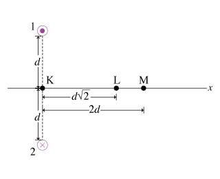

We have wires like in the picture and we want to know the value of magnetic field as
function of x:
NOTE: We want to know the magnetic field at point P ( P is on +x axis ) ( Which is totally arbitary!) The picture is there for just to give the idea.
R is the distance from each wire to point P.
[itex]H = \frac{I}{2 \pi R }[/itex]
Okey, so the currents are going in opposite ways. By the right hand rule we get the direction of the magnetic field due to each wire!
We notice that the y-component cancels out ( due to symmetry ), and that the magnetic field is only the x component due to each wire at point P.
So by superposition principle we get the magnetic field at point P on x -axis:
[itex]H = sin(\theta) \frac{ I }{ \pi R }[/itex]
Now [itex]sin(\theta)[/itex] is the angle between x-axis and the distance R from each wire.
So we get from trigonometry:
[itex]H = \frac{d \cdot I }{ \pi R^2}[/itex]
[itex]H = \frac{d \cdot I }{ (x ^2 + d ^2 ) \pi }[/itex]
Not sure if this is right? At least the units match ( A / m ), but... problem is:
My assigment gives us only the current I and the x -axis distance to point P? So I assume the right answer of the magnetic field at point P should be independent of d? But that doesn't make sense to me.
If θ is the angle between the x-axis and R, make sure you are using the correct trig function for getting the x-component.
Hmm, as the distance vector R from one wire and magnetic field from same wire are perpendicular I get that the x component of magnetic field by that wire
so [itex]sin(\theta) = \frac{d}{R}[/itex]
and
[itex]R^2 = x^2 + d^2[/itex]
Sorry, my mistake. You are entirely correct. The answer does depend on both x and d.
No problem at all, wouldn't have been the first time I make the mistake on the easiest part of the problem. ^^
