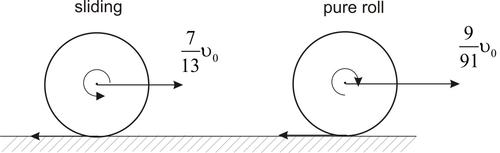

Uniform sphere of mass ##m## and radius ##r##, rolling without slipping on a horizontal surface at a velocity ##v_0##, hits the end of a rod of length ##l## and mass ##10m##, hanging on a hinge (Figure). Determine how the ball will move and the rod after the impact. What time after, the motion of the ball goes into pure rolling? What is the speed of the roller? An impact is perfectly elastic and instantaneous. The coefficient of friction of the ball on the plane is ##k##. Rolling friction neglected.
Eqs of conservations:
Angular momentun: ##mv_0l=\dfrac{10ml^2}{3}\omega-mvl##
Energy: ##\underbrace{\dfrac{mv_0^2}{2}+\dfrac{2}{5}mr^2\dfrac{v_0^2}{2r^2}}_{\dfrac{7mv_0^2}{10}}=\dfrac{10ml^2}{3}\dfrac{\omega^2}{2}+\dfrac{mv^2}{2}##
I feel that I made a conceptual error in the conservation laws, but I do not know where.

You omitted the rotational energy of the ball from the energy equation.

sergiokapone said:
Then, we have
##v=\dfrac{7}{13}v_0##, ##\omega=\dfrac{6}{13} \dfrac{v_0}{l}##
But why the sphere does not stop spinning?
The rod hits the ball at the height of its centre. So the rod does not exert torque about the centre of the ball. No torque, no change of angular momentum. (The force of friction is finite, it does not have effect on angular momentum in infinitesimally short time)

Now I start to calculate the time from bounce to pure roll.
I have two eqns:
##m\dfrac{dv}{dt}=-F_{f}##
##\dfrac{2}{5}mr^2\dfrac{d\omega}{dt}=-F_{f}r##
Here not mess with the signs?

Take care of the signs.
After collision, the ball travels to the right and spins anticlockwise. When it starts to roll it travels to the right with velocity v and rotates clockwise with ω=v/r. The friction accelerates clockwise rotation.

Right calculations:
From integrating above eqns:
##\dfrac{2}{5}\omega r-v=const##
Constant determine from initial conditions, e.g. ##const=\dfrac{2}{5}\dfrac{v_0}{r} r-\dfrac{7}{13}v_0=-\dfrac{9}{65}v_0##
When will the pure rolling ##v=-\omega r##, then ##\dfrac{2}{5}\omega r+\omega r= -\dfrac{9}{65}v_0##
E.g.
##\omega r = - \dfrac{9}{91}v_0##
##v=\dfrac{9}{91}v_0## - velocity of pure rolling.
Then
##v_{at\; the\; finish\; of\; sliding,\; or\; starting\; pure\; roll}=v_{initial\; velocity\; after\; bounce} +at##
or
##\dfrac{9}{91}v_0-\dfrac{7}{13}v_0=at##
##-\dfrac{4}{13}v_0=at##
##t=-\dfrac{40}{91}v_0\dfrac{1}{a}##
From the eqn of center mass motion ##a=-kg##
Answer ##t=\dfrac{40}{91}\dfrac{v_0}{kg}##
