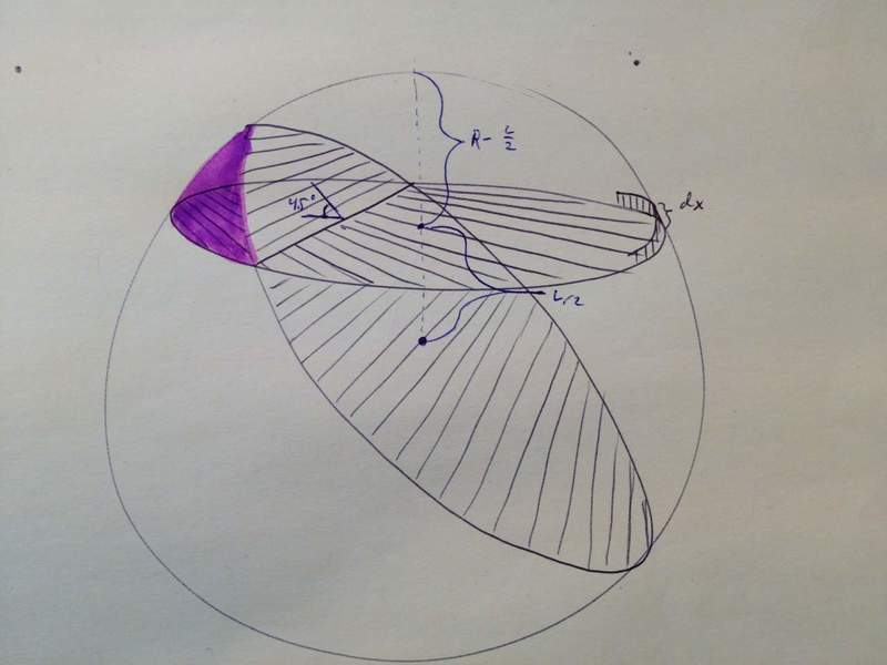

Ok, so a cube and a sphere are both centered at origo. The cube has side lengths L. I need to know the surface area of the part of the sphere that is inside the cube, for all possible r. There will be three different equations, one for [itex]0 < r < L/2[/itex], when the entire sphere is inside the cube, one for [itex]L/2 < r < L/\sqrt(2)[/itex], when six spherical caps of the sphere stick out of the cube sides , and one for [itex]L/\sqrt(2) < r < L\sqrt(3) / 2[/itex], when only the corners of the cube is visible. I have figured out the two first, but not the last.

OK. The reason I did not show my work is because i believe there must be a much simpler way. But her it is.
If I am not mistaking, the area X of the sphere INSIDE the cube is the total area A of the sphere, minus the area C of the six spherical caps, plus the area of the overlaps E between the caps near each of the 12 edges (because it has been subtracted twice). So [itex]X = A - 6C + 12E[/itex].
I have found A and C:
[itex]A = 4\pi R^2[/itex]
[itex]C = 2\pi R h = 2 \pi R (R-L/2)[/itex]
Now I only need E, the intersection / overlap between two adjacent spherical caps. In the attached drawing, the colored area is HALF of E. E has been divided in the middle by the arc of a great circle. Finding the colored area have proved more difficult than I expected, though.
