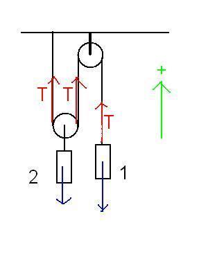

Non-extensible cable attached to ceiling. Cable goes down, around a pulley and then back up, then over another pulley and down. At the end of the cable is mass 1. Hanging from the first pulley is mass 2. I am trying to find a formula for the acceleration of M1 as a function of the mass of 1 and 2.
I have set g = -9.8m/s^2 (positive acceleration is up, negative is down)
I have a free-body diagram for mass 1:
Total force on mass 1: f1 = f1(up) + f1(down)
f1(up) is the force imparted by the cable pulling up
f1(down) = m1 * g
And for mass 2:
Total force on mass 2: f2 = 2 * f2(up) + f2(down)
f2(up) is the force imparted by each of the two cables lifting on the pulley above mass 2.
f2(down) = m2 * g
I set also f2(up) = f1(up) since the same cable that holds mass 1 also goes to the pulley for mass 2. This is my first question - is this assumption of the forces upward correct?
I also say that because of the pulley arrangement the acceleration of mass 1 (a1) = 2 * the acceleration of mass 2 (a2). I say this because the velocity of mass 1 is double the velocity of mass 2 (due to the pulley arrangement).
So we have:
a1 = 2 * a2
f2(up) = f1(up)
a1 = (f1(up) + f1(down)) / m1
a2 = (2 * f2(up) + f2(down)) / m2
Is this correct so far?

You mixed up the signs. The block 1 and 2 move in opposite directions so a1=-2a2.
It is a bit difficult to follow your notations. The upward forces come from the tension in the string, and it is the same everywhere if the pulleys and the string itself are massless. We usually denote the tension by T. Taking upward the positive direction, you have the equations
m1a1=T-m1g
m2a2=2T-m2g
and a1=-2a2
ehild

If a is the acceleration of m1, the acceleration of m2 can not be a/2, as they move in opposite directions (one upward, the other downward).
ehild
m1a1=T-m1g
m2a2=2T-m2g
and a1=-2a2
ehild
Yes, you're right! The wrong sign on a was the key.
Now I get:
a1 = 2g(2m1 - m2) / (m1*p^2 + m2)
