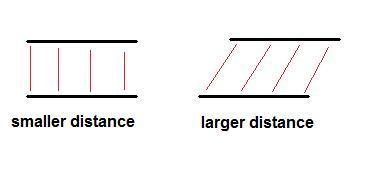

We have two conducting plates. One is moveable, the other is not moveable. The moveable has the charge of +1V. While the other plate has the charge 0V and is part of a enclosing envelopment. See fig:
http://tinypic.com/view.php?pic=wb2onm&s=6
But when we move the upper plate horizontaly shown in the figure below the capacitance gets lower.
http://tinypic.com/view.php?pic=4hcrbb&s=6
In the figure the E-field and potential is plotted. How am I to motivate why the capacitance gets lower?

There are two ways to describe the motion:
A) The distance between the plates increases. As the charge is the same, the electric field strength is the same, and the voltage increases. Using Q=CV, this has to correspond to a smaller C.
B) The area (of overlap) decreases. Therefore, less charge contributes to the capacitance, while the voltage stays the same. Using Q=CV, this has to correspond to a smaller C.
Both views are just approximations to the real setup, and you would need a numerical calculation to do it properly, but they give the right direction.

The vertical distance is the same, but there is an additional horizontal distance afterwards. In particular, the outer parts of the plates have a larger separation from the other plate.
Can I use the formula C = εS/d and because the overlap decreases and d is constant, then C decreases?
What is S? I don't think there is a nice general formula for shifted capacitor plates. Just using the area of overlap gives a value which is too low.
If so, then V = ∫Edl and the voltage between two plate isn't the same at every two points between two plate?

Sketch (very qualitative):
E is not constant any more, it depends on the position.

Nice pic! I see it now, thanks mfb.
