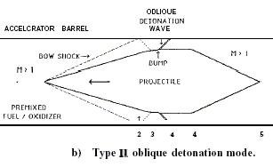

Till some time ago, my senior year project was the numerical simulation of a RAM accelerator, similar to a RAMjet but with a premixed burning. I got some AIAA papers directly from one of the discoverers of the technology at U. Washington. The two figures attached correspond to a Ramjet (subsonic combustion), and a RAM accelerator working at Supersonic Premixed Combustion or Superdetonative mode. There you can view the influence of the diffusing after entering the combustion chamber.
Due to the difficulties of setting up an edible code of Reactive Euler Equations, I have returned to boundary layer theory and axisimmetric jets, which are involved in my actual senior project.
The fact is didn't know that object of the photograph was called "ramjet". Here it is called "stato-reactor", but it has little to do with Ramjet technology.
If so, I think all what Fred has said answers your question.
